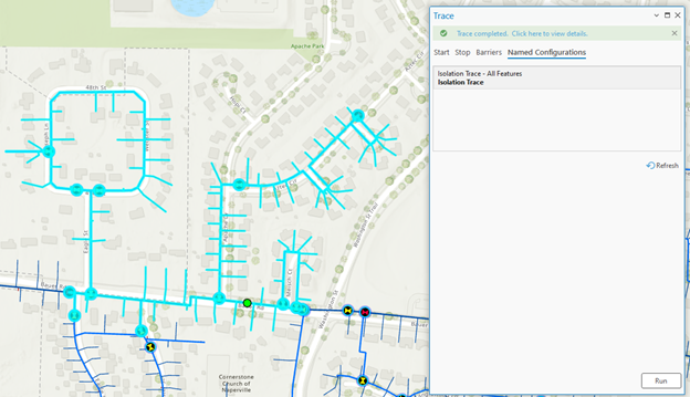

If your utility network already has an isolation trace configured, running an isolation trace is as simple as opening the Trace pane, setting a start location, and running the trace from the Named Configuration tab. The answer to your isolation question will then be displayed on the map, as shown in the screenshot below:
Named traces allow users to quickly run different pre-configured traces.

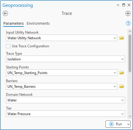

If you don’t already have an isolation trace configured, or you want to change the behavior of your existing isolation trace to answer a slightly different question, then you can use the Trace geoprocessing tool to configure and run an ad-hoc trace.
When configuring an isolation trace you must identify the domain and tier to be considered for analysis. This is because an isolation trace needs to know which sources/sinks to consider when identifying the extent of the isolation area. Depending on the domain and tier being analyzed, the trace solves different problems:
  • In a gas or water pressure zone you are identifying the area that will lose pressure within the network.
  • In an electrical circuit you are identifying the area that will lose power.
  • In a sewer or stormwater network you are identifying the area that will be contained in order to prevent contaminates from leaving the area.
While each of these analyses has a different set of assets and trace configurations associated with it, selecting the correct tier of the utility network ensures the trace produces an accurate result.
In this example we will be running an isolation trace on a water network, choosing to isolate based on the Water pressure source(s) of this system. This was chosen instead of the Water System tier for several reasons. Using the Water System (which represents all water sources) requires analyzing more features and doesn’t consider how sufficiently water storage devices such as   storage tanks, standpipes, water towers provide water specific areas in the network. If you wish to understand impacts on an area of the network that will be without water for an extended period, you may want to use the Water System tier instead or consider using a hydraulic model to analyze operational impacts on the water system over time.
The Isolation trace type allows you to identify how to isolate a part of your network as well as the features isolated.

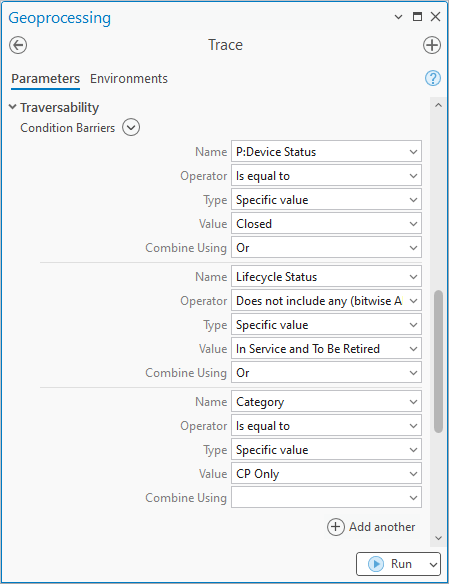

By selecting the Water Pressure tier the Trace tool will automatically be populated with the condition barriers configured for that tier’s subnetwork definition. In this case the Water Pressure tier is configured to stop at closed valves, features that aren’t active in the network, and equipment used exclusively for cathodic protection.
Each subnetwork definition includes condition barriers that describe the normal state of the system

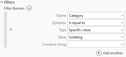

Therefore, to perform an isolation trace a second kind of barrier is needed that allows you to identify the features used to isolate portions of the network. This is where the filter barrier comes in. A filter barrier allows you to define a separate set of criteria that will identify candidate features to isolate an area of the network.
Filter barriers allow you to identify criteria used to identify the features that will be used to isolate the desired area of the network.

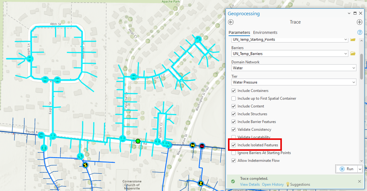

The isolation trace identifies the features used to isolate the desired section of the network, as shown with arrows in the image above.
By default, the isolation trace will only return the features that isolate the area. If you want to also include the affected features in the result, you must select the Include Isolated Features option.
Choosing the include isolated features option will also show the isolated features.

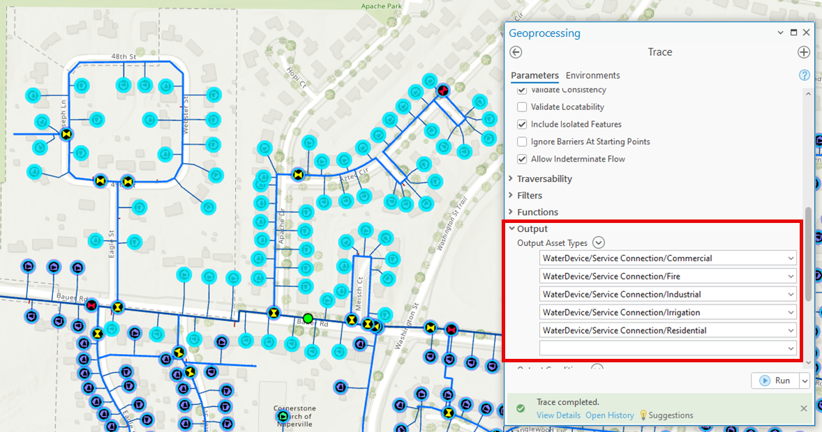

In a situation where a large area is isolated you often want to know if certain types of equipment are affected. These may be large commercial or industrial customers, sites that are sensitive to service interruptions such as hospitals, or other types of critical infrastructure. The good news is that if this information is available in the network data, the trace results can be configured to draw attention to these important areas. The primary way of doing this is by controlling which features are output by the tool.
The easiest way to limit the output is by using the asset types of the features involved. This allows you to only include certain types of features in the results, regardless of their other attributes or configurations. The trace below returns only customer services by enabling Include Isolated Features and setting the Output Asset Types to the different types of service connections.
Use output asset types to limit the output to specific types of features

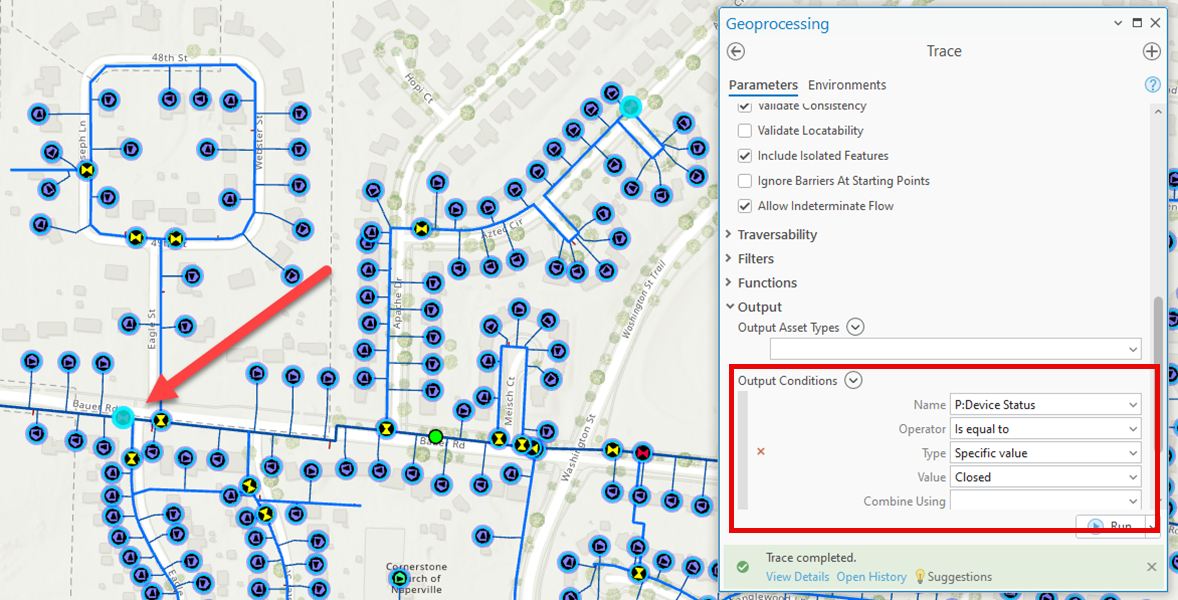

Output can also be controlled using network attributes or network categories. This allows you to configure an output condition, like a condition barrier or filter barrier, to determine which features to output using network attributes or network categories. In the example below the output is filtered to return closed valves. These are valves that could be used to provide alternative water sources in an emergency.
Use output conditions to use network attributes to identify important features like closed valves

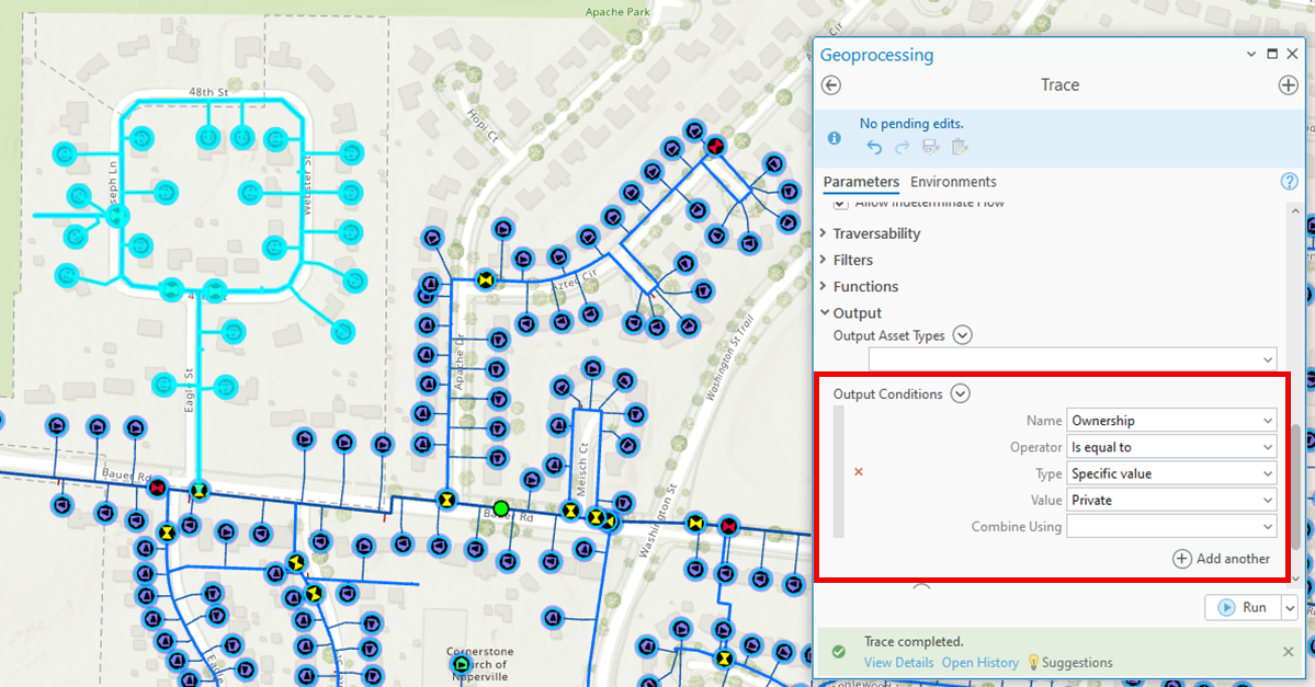

The example below uses a network attribute to identify equipment owned or operated by another organization. This is an important consideration when looking at equipment used to isolate an area, as you may need to coordinate the outage or interruption with another organization. In the example below you can see a small portion of the neighborhood has infrastructure that is privately owned, so you will need to coordinate the outage closely with the property owners.
Output conditions can be used on any network attribute or category, not just those included in your subnetwork definition.

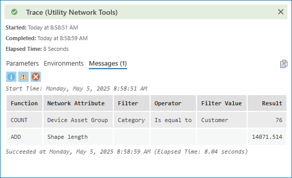

In addition to controlling what features are returned in the trace, it’s often desirable to perform some calculations about the affected area. While this could be done by limiting the results and performing calculations manually, the trace can also be configured to perform some basic calculations.
Functions
When running the isolation trace it’s possible to perform some basic calculations using the Functions parameter of Trace tool. Even though the calculations are simple, they provide more detail about the results without needing to review attributes on any features. The calculations are performed across all the resulting features, using any network attributes and a basic mathematical operator. Examples of calculations include the following:
  • Count – How many customers are affected?
  • Add – What is the total length of pipe or wire affected?
  • Min – What is the smallest diameter pipe in the affected area?
  • Max – What is the largest demand or load that is impacted?
Use functions to provide summary statistics for the features identified by a trace

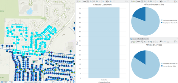

While it’s not possible to do more granular reporting using the trace dialog directly, it is possible to use the selection from the trace to populate a chart in either ArcGIS Pro, ArcGIS Experience Builder, or ArcGIS Dashboard.
Using this technique, you can create more interesting visualizations like the examples below:
Integrate charts into your traces to provide additional insights about the types of customers or features affected.

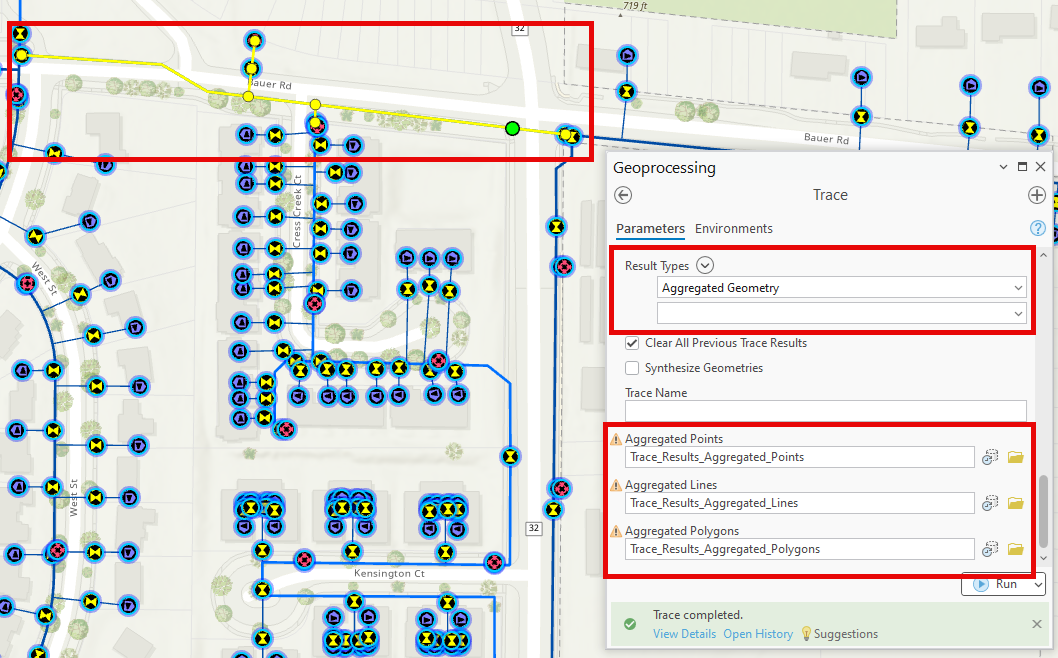

In this article you have seen how to visualize the results of the trace through map selections, summary statistics, and charts. These methods work well for most situations, but a common issue with visualizing using the map and selection sets is that lines aren’t always split at the location where the system is isolated. In these cases, the entire line (like a large distribution main) will be selected, even though the trace really stops at a system valve in the middle of the pipe. This gives the impression that the extent of the outage is much larger than it is, as you can see below.
Trace return results as a selection by default, this can lead to confusing results if your lines aren't split at barriers
In the above graphic a single customer is affected, but because the valves being operated are on a large distribution main that hasn’t been split it appears as if a larger area is affected. This happens because ArcGIS Pro is selecting the entire feature and doesn’t have a way to select individual segments within the feature. The way to handle this with trace is to use the Aggregated Geometry result type to populate a layer with the geometries of just the features that were affected.
Use aggregated geometries to store your results as features that respect the partial edges caused by complex edges and function barriers.
When selecting this option, you can choose to update an existing layer with the results and can even choose to append the results with a unique name so multiple results can be compared. It is important to use the aggregated geometry result type when using a function barrier on length field to stop after a certain distance. This ensure that the trace result only shows the partial length of the edge that satisfies the function barrier. Learn more about this by reading the function barriers topic in ArcGIS Help.
