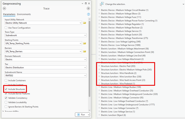

This joint use assessment is often incorporated into inspection programs performed by utilities to inspect and maintain their circuits. Because the utility network models all the equipment and conductors attached to a pole, all you need to do to get the poles associated with a circuit is to run a trace for the circuit you are inspecting and choose the Include Structures option. Once you have all the poles in an area you can ensure that you have access to all the joint use attachment agreements for the structures in the area you will be inspecting.
Including structures in your trace causes the trace tool to include any features attached to the trace results.

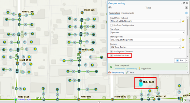

This is another area where the utility network can assist. The first thing that the utility network can do is run an upstream trace to identify all the customers upstream of the blockage that participate in the FOG mitigation program. This trace can serve to not only identify the customers but also identify any FOG mitigation equipment that they maintain. There is a wide variety of equipment that can be used in a FOG mitigation program, but it is typically installed either underground or requires access to a special room in a building. By tracking the access locations in the GIS, and making them containers for the FOG equipment, we can use the Include Containers option as part of the trace to quickly identify whether the equipment is accessible via a nearby manhole or elsewhere at the customer site.
Including containers in the trace causes the trace results to include the containers for your trace results.

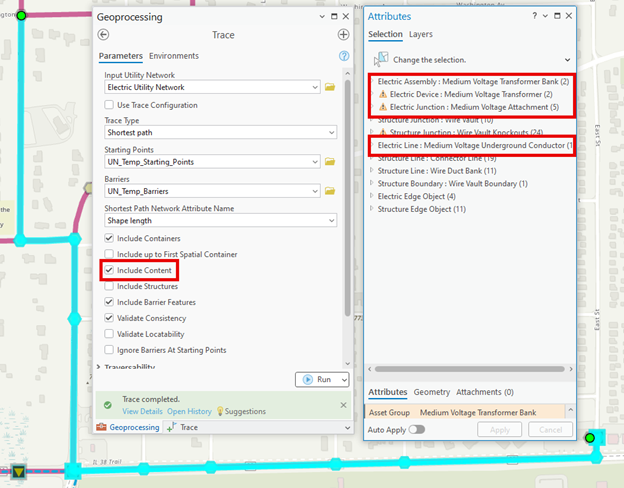

When building out new construction it’s important to not only know that there is a path between two points, but you also need to know it has spare capacity. While it’s possible to manually track the availability of a conduit using an attribute, you can also answer the same question using a trace. By selecting the Include Content option when tracing your conduit network, you can not only see whether the conduit is occupied, but also which cables occupy those conduits. If your new project is large enough, like installing a new data center, you may even choose to reroute existing cables to make room for the new construction.
Including content in the trace causes the trace results to include the content for your trace results.
