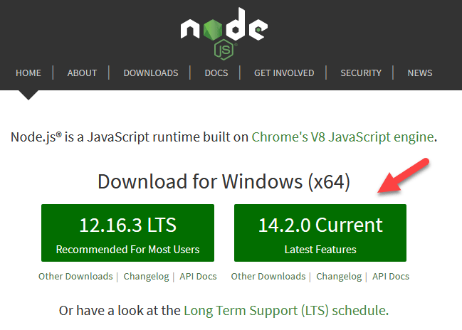

The installation process of the tool is simple. All you need to do is to install Node JS 13.x or higher. The current version of Node JS is 14.x.
Once you install Node js , open a command line prompt and type in the following
npm install -g un-cli

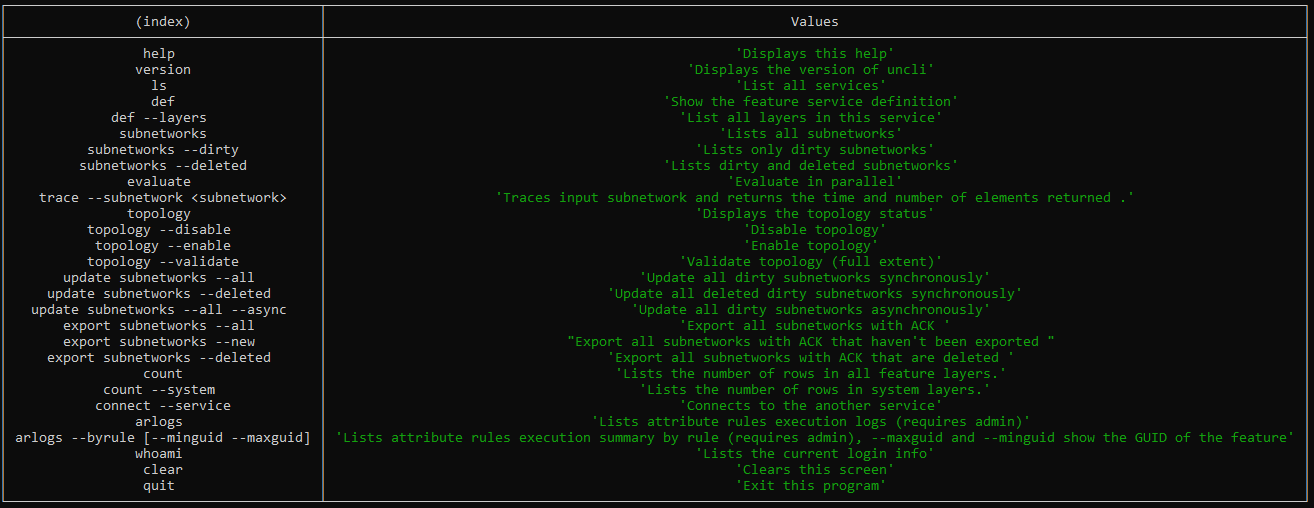

Help
>help
At any time you can type “help” to get a list of all commands available.

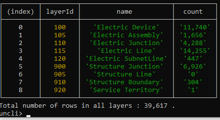

Get Count of Features
> count
Count how many features you have in your Utility Network

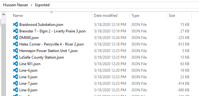

Export All Subnetworks
>export subnetworks -all
This command exports all subnetworks that have been cleaned and successfully updated and writes the exported json in the home directory.
Export New Subnetworks
>export subnetworks -new
This command exports all subnetworks that have been cleaned and successfully updated but haven’t yet been exported and writes the exported json in the home directory.

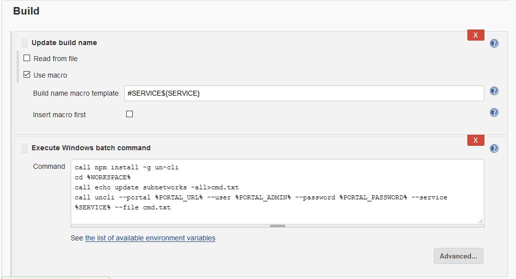

Jenkins is an automation server that allows you to automate tasks, this tools works with Jenkins as well
