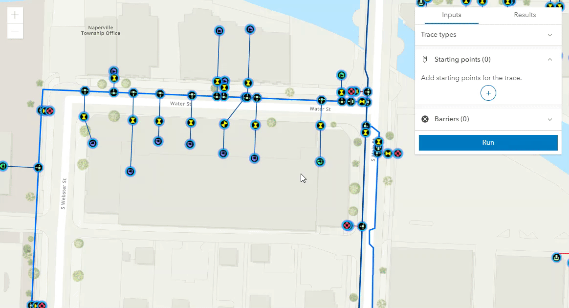

Step 1. Select trace types
For this use case, the widget loads with two traces already selected in the Trace types dropdown. These two traces are different configurations of the Isolation trace. One of them will return the isolating features (the system valves that need to be closed to stop the flow of water), and the other trace will return all the isolated features (the features where the water will stop flowing).
Select the trace types to run

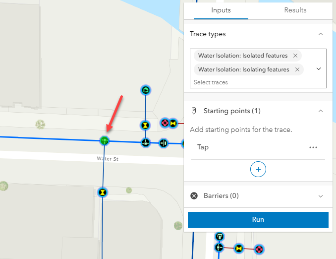

Step 2. Add starting points
I will add a starting point at the leak location since this is where I need to stop the flow of the water, so the repairs can be made.
Place a starting point at the location of the water leak. This is where traces will start.

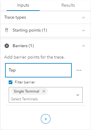

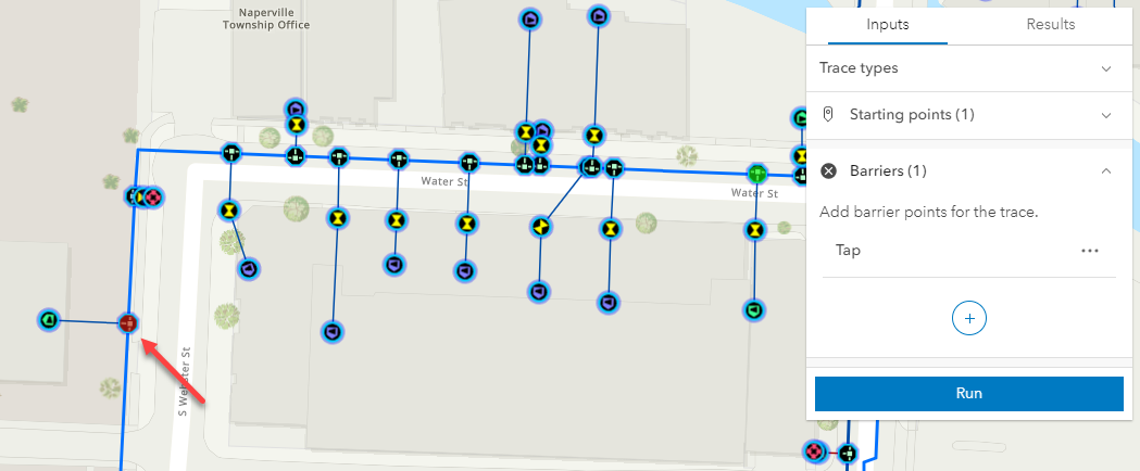

Step 3. Add barriers
Optionally, set features in your network as barriers for a trace. For example, a section of the water network is closed due to another field team doing work in the area to install a new system valve. I can place a barrier to exclude that part of the network in my trace results.
Place a barrier where the trace needs to stop
These feature barriers can also be treated as filter barriers to first discover the subnetwork controllers before applying the barriers.
Use the checkbox to set a barrier as a filter barrier

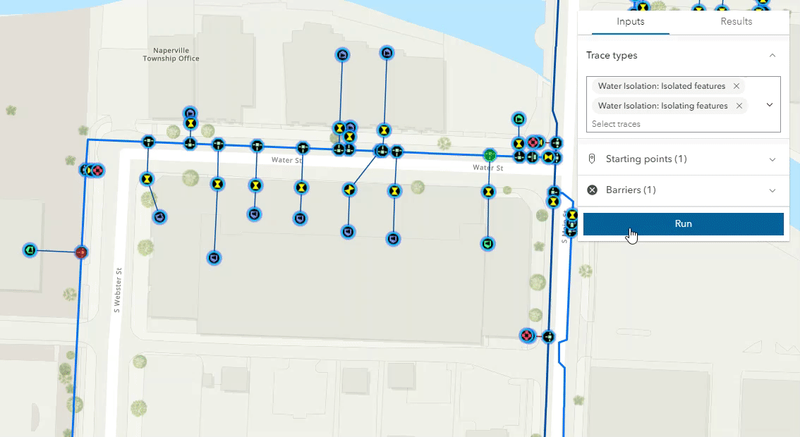

Step 4. Run the trace
Once I’ve selected the trace types and set starting points and barriers, I can click Run to execute the traces. All traces are run concurrently and results are returned as the traces are completed. The trace results can be displayed as a selection, graphics, or both.
Click Run to execute the traces

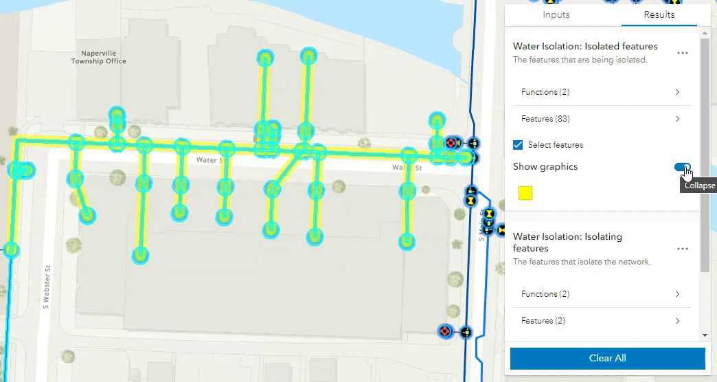

The type of results for a trace operation can be defined with the Result Types parameter when adding a named trace configuration to your utility network feature service. The Aggregated Geometry and Selection result types can be specified independently or concurrently to generate output geometries and create a selection set for a trace.
If Aggregated Geometry is specified, the results from the trace are aggregated by geometry type and displayed as a graphic layer on the map. Toggle the graphic layer on or off and change its display color.
Toggle to show graphics on the map and change the color

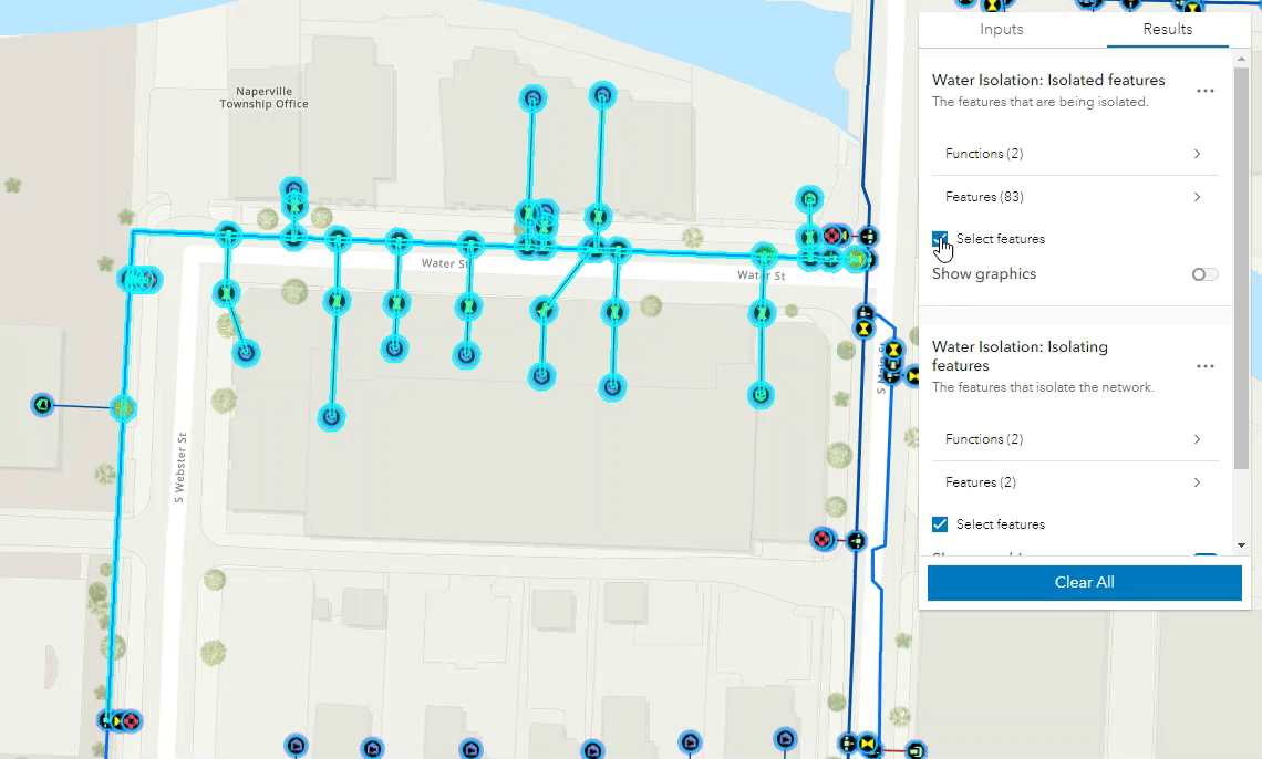

If Selection is specified for the result type in the named trace configuration, then the results for the trace are returned as a selection set. Also, this is the default behavior if no result type is defined in the trace configuration. Use the checkbox to select and clear the features on the map and explore the list of selected features organized by asset group and asset type.
Note: The list of selected features is only available if the showSelectionAttributes widget property is set to ‘true’ for this application.
Select the results on the map and view the list of features

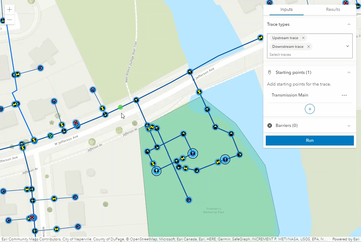

Upstream and Downstream example
Following similar steps as in the water isolation example above, I can run different trace types such as Upstream and Downstream, and quickly visualize the results using different graphic colors.
Upstream and Downstream traces
Run upstream and downstream traces and visualize the results using colored graphics
