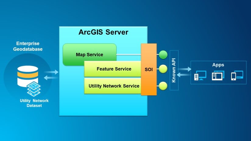

Server Object Interceptor (SOI)
The other option is to build a Server Object Interceptor to add your own business logic inside existing service operations. Extra processing steps can thus be added to existing Map Service REST operations, or to any of its extensions, including the Utility Network Service. This is done without modifying the existing ArcGIS Server REST API. Adding extra user access checks on certain REST operations or doing pre- or post-processing work when validating network topology are examples of what you could do in a SOI.
Create a Server Object Interceptor (SOI) to add custom business logic to the existing REST API
