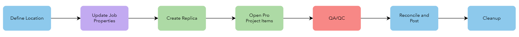

Let’s take a look at how this diagram works:

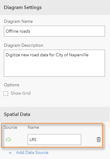

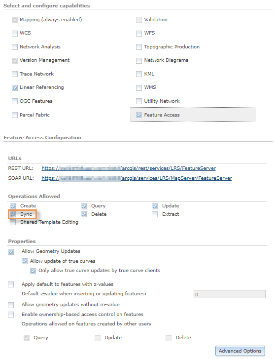

The GIS Analyst publishes the linear referencing data as a feature service to the transportation department’s Enterprise portal. Before the feature service can be published, the linear referencing feature service must have branch versioning enabled. This is done in the data source section of the feature service’s settings page.

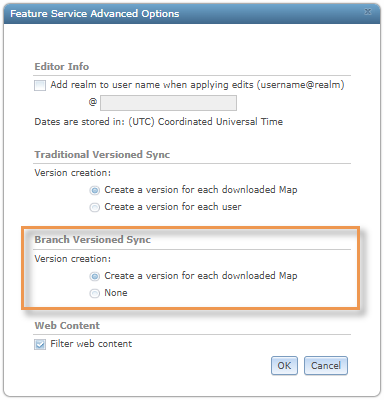

After the feature service is published, the GIS Analyst updates the Feature Service Advanced Options in ArcGIS Server Manager to allow a new version to be created when the branch versioned data is replicated.
Enabling the sync operation allows mobile workers to synchronize edits with the replicated data
The linear referencing feature service has been configured and can now be used as the data source associated with our offline editing diagram in Workflow Manager.
The linear referencing feature service associated with the offline editing diagram

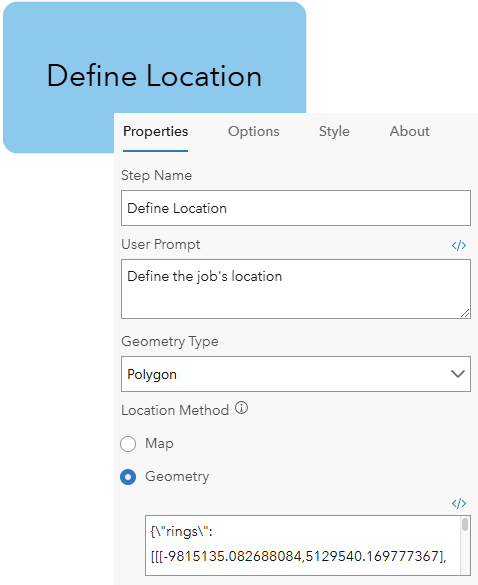

To distribute tasks to the mobile worker, a location of interest must first be defined. Defining a location of interest narrows the extent of the location where data-editing is performed and minimizes the amount of data that the mobile worker would need to download locally.
A location of interest can be defined by opening a map and selecting the geometry based on map layers, or it can be defined with an ArcGIS Arcade expression that returns the location’s geometry with the Define Location step.
Coordinates used to define the job's location and the extent of the replicated data

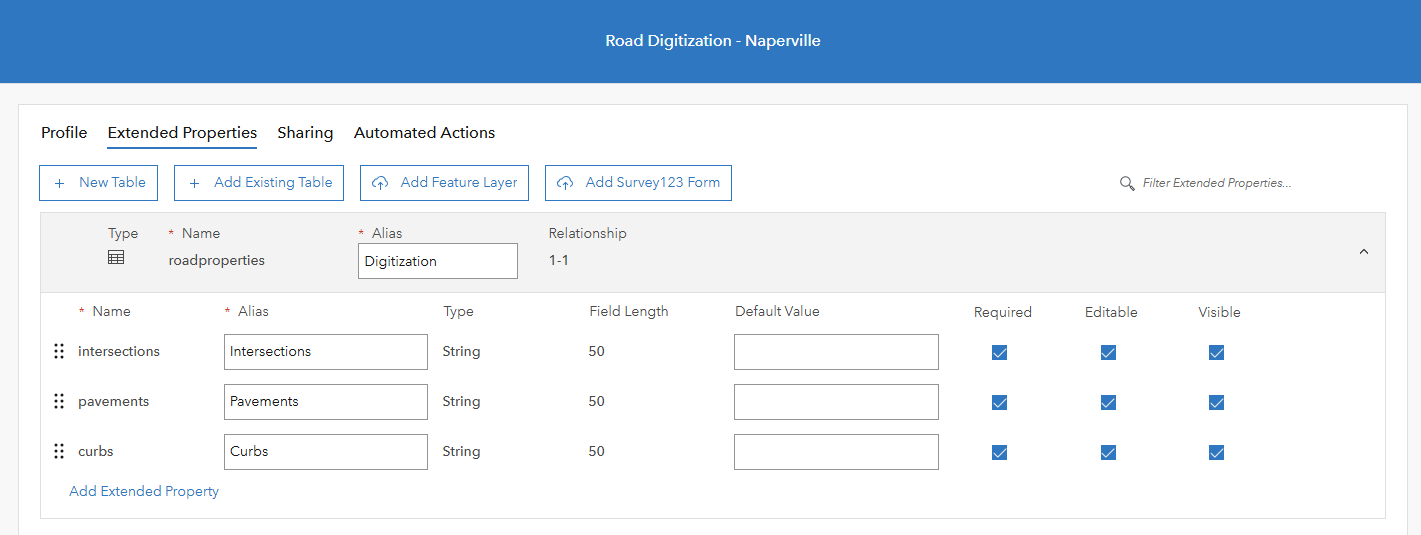

To obtain details about our road digitization request from the transportation engineer, we’ll first need to create an extended property table to associate updated properties with our offline editing job.
The road data's extended properties table associated with the offline editing job template

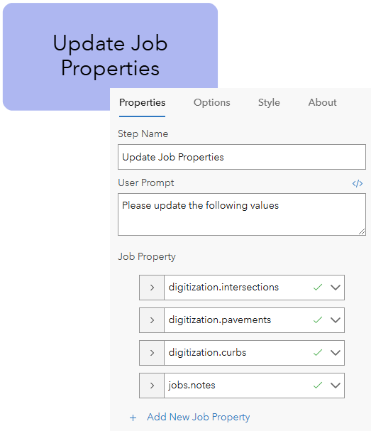

The Update Job Properties step can then be used to update the pavements, intersections, and curb properties that we associated with our job’s extended property table.
The Update Job Properties step configured with the road digitization extended properties

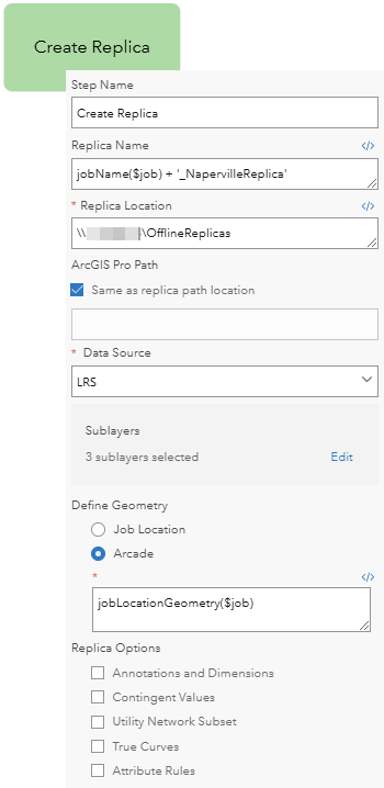

The key component of our workflow diagram replicates the data for the defined area of interest, saves it to a shared file location, and allows the mobile worker to access and edit the layers in the field. The Create Replica step is used to create a branch version of the data, which stores it in the form of a mobile geodatabase accessible by ArcGIS Pro.
The Create Replica step configured to replicate the LRS data source based on the job's defined location

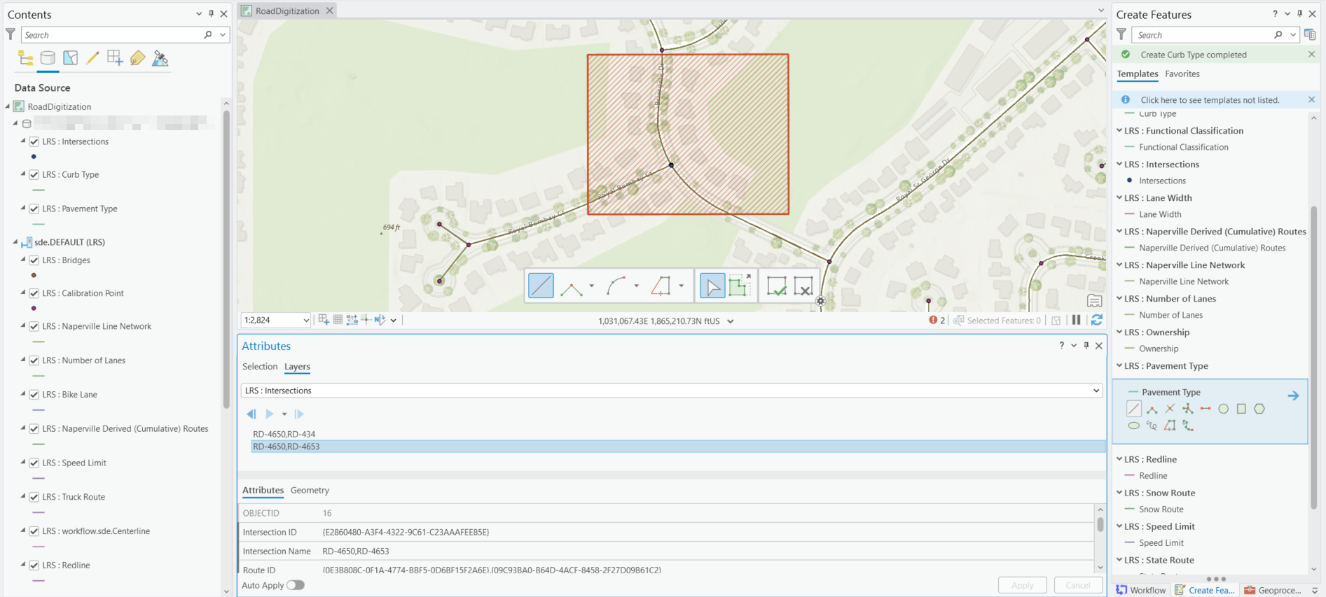

Once the data has been replicated and stored locally, the mobile worker can perform data editing in ArcGIS Pro by opening the pre-defined map with the Open Pro Project Items step.
The step is associated with an ArcGIS Pro project package hosted on the transportation department’s Enterprise portal and configured with a two-way synchronization on the Start and Finish tabs of the step. When this option is enabled, changes can be sent to and received from the mobile geodatabase when the project is opened, paused, or completed.
The Open Pro Project Items step configured with a hosted project package and configured to sync changes when the project is opened, paused, or completed
When the project is opened in ArcGIS Pro, the data source of the road map is repointed to the replica mobile geodatabase created by the Create Replica step. Because Create Replica was configured to replicate specific layers, the map opens in ArcGIS Pro and repoints those layers to the replicated data.
The road map project opened in ArcGIS Pro synchronizes edits when the step is paused or completed

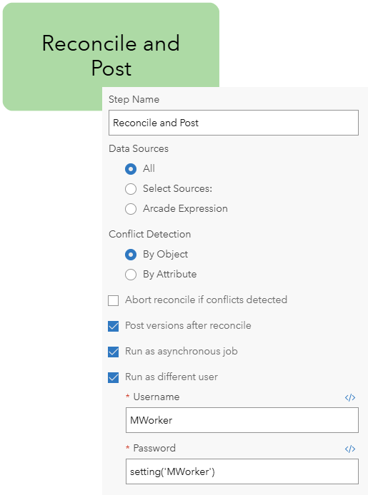

Once the team has approved the edits made by the mobile worker, changes can be pushed from the replica to the default version with the Reconcile and Post step. This step can be configured to check for specific conflicts and allow the team to resolve those conflicts before posting edits to the default version. Given the reconcile and post process may take some time, we can optionally choose to run this process asynchronously.
Reconciling and posting can only be performed by the replica owner, which in this scenario is the mobile worker who opened and ran the create replica step. As the GIS analyst, we can configure the mobile worker’s credentials using an encrypted user-defined setting to reconcile and post the data on their behalf once data checks have passed.
The Reconcile and Post step detects conflicts and posts edits once conditions have been met

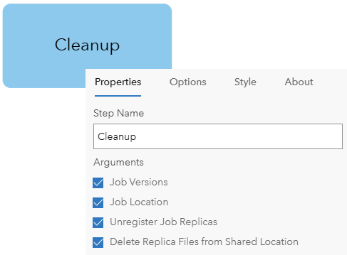

Finally, after edits have been posted to the default version, we can allow Workflow Manager to clean up the job data using the Cleanup step. This process deletes the location associated with the job, unregisters the replica with the job, and deletes the replicated version of the data source and the mobile geodatabase stored in the shared file path.
Clean up job data by removing the job location, unregistering the replica, and deleting replica files from the shared file location

This process outlines a repeatable workflow that can be used to standardize work across organization members to update a linear referencing network. By leveraging an offline editing workflow, data distribution and assignment to mobile workers becomes scalable, offering the flexibility to continue making edits and posting changes in areas with limited connectivity.
