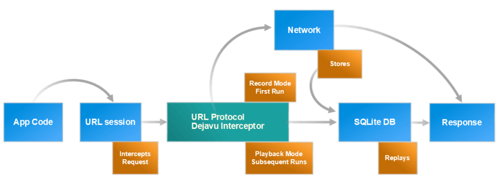

Dejavu intercepts URLSession requests during a recording run and writes each request and its server response to a local SQLite database. In playback runs, the same requests are intercepted and matched to the recorded entries; the exact responses are returned instantly, without hitting the network. The result: tests that are fast, repeatable, and resilient (with modes you can toggle per run).

How it works (high level, no code)
  1. Intercept: Register Dejavu’s URLProtocol for the URLSession your tests use.
  2. Record: In a recording mode, write the full request/response pair to a SQLite file. We use Record only as needed. For example, we create a fresh recording when tests change, requests change (params, headers, etc.), or when we need to resync with services.
  3. Match: On future runs, match outgoing requests to recorded ones.
  4. Replay: Return the exact recorded response locally—no live I/O.
    (Usage overview and modes documented in the package: GitHub, SPI)
