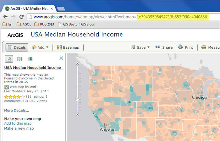

Step 1: Open the USA Median Household Income map. Each map has an ID. Like your social security number or driver license, this ID is unique and can be used to reference the map. You’ll find the ID in the URL for the map. Simply highlight it and copy it. Do not copy the complete URL.

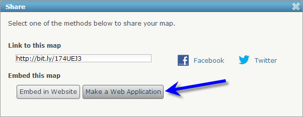

Step 2: Open the second map you want to compare, in this case it’s USA Unemployment Rate. Once opened, click Share and then choose Make a Web Application.

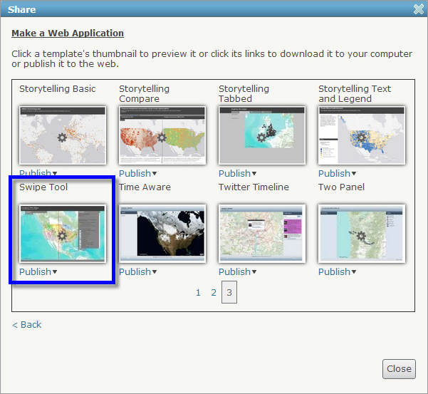

Step 3: Locate the Swipe Tool, currently found on page 3 of the template gallery.
Step 4: Click the arrow next to publish, and choose Preview as shown below:
