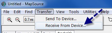

Connect your GPS device to your computer, and use your GPS software to transfer the data from the device:

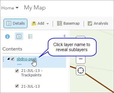

Once imported, your GPX file will display on the map. But depending on what you captured using your GPS device and exported to the GPX file, you may have sublayers you can toggle.

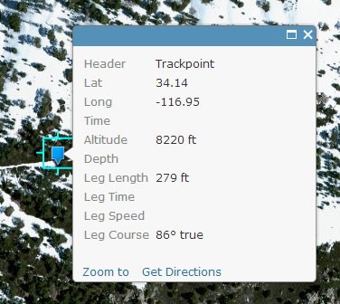

For example, the GPS device captured both the track and waypoints, and both were exported in the GPX file. By default, only the track was visible after importing. To display other sublayers, click the layer name to reveal them, and check those you want to display:

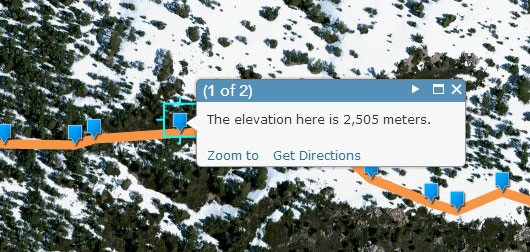

You can change symbols, adjust transparency, and configure the pop-ups, just like other layers. In the screen capture below, the symbols have been changed and the pop-up configured:
