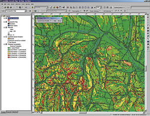

Landslide Probability Map showing increased susceptibility in orange to red colors.

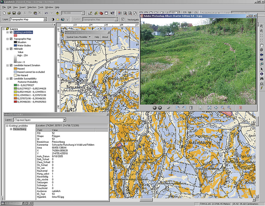

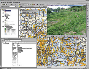

Users at the Burgenland government can navigate through the hazard map, query information, and display photos of known landslides.
