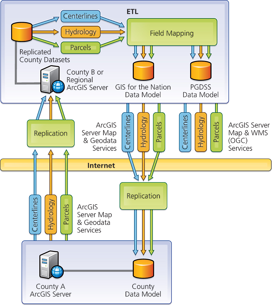

A federated GIS is based on a distributed collection of connected GIS nodes that share and use each other's geographic information and services. In this case, a county's enterprise geodatabase serves as a node. ArcGIS Server 9.2 enabled this architecture with replication, which allows copies of a geodatabase to be distributed to other counties' GIS based on an agreed-upon schedule that could be monthly, daily, or more frequently. During a crisis, updates can be made in near real time.

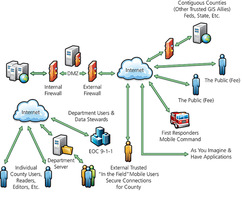

The Pennsylvania Federated GIS was designed to be resilient: if one county's GIS data becomes inaccessible in a crisis, it is still accessible at other locations in the state. Other servers in this connected group could immediately stand in for a disconnected node. From a remote location, the disconnected county's replicated data will run seamlessly in GIS applications.
To achieve this resilience, the Pennsylvania Federated GIS is decentralized. A central server would make participating counties depend on one county, or one physical location. In the event of an emergency that debilitated the central server, there wouldn't be a backup.
typical county configuration
Typical/Preferred Individual Participating County Configuration

The ArcGIS Data Interoperability extension was essential in supporting each county's individuality. The extension eliminates barriers for data sharing since it reads more than 75 spatial data formats and can export to more than 50 spatial data formats. Participating counties have direct data access, as well as transformation and export capabilities, so they can integrate various data types into their GIS.
The ArcGIS Data Interoperability extension allows the counties in the pilot to process their data and load it into the GIS for the Nation data model or other unique standards, like the Pennsylvania Geospatial Data Sharing Standard (PGDSS), depending on each county's preference. This is typically referred to as an extract, transform, and load process, which creates a seamless data layer. The GIS for the Nation data model is a data-sharing information model for local, state, tribal, and other national data themes. PGDSS is a standard born out of Pennsylvania's need to facilitate data sharing among the commonwealth's various organizations; it focuses on unique attributes of Pennsylvania.

Workflow Diagram of the Export, Transform, and Load (ETL) Process
