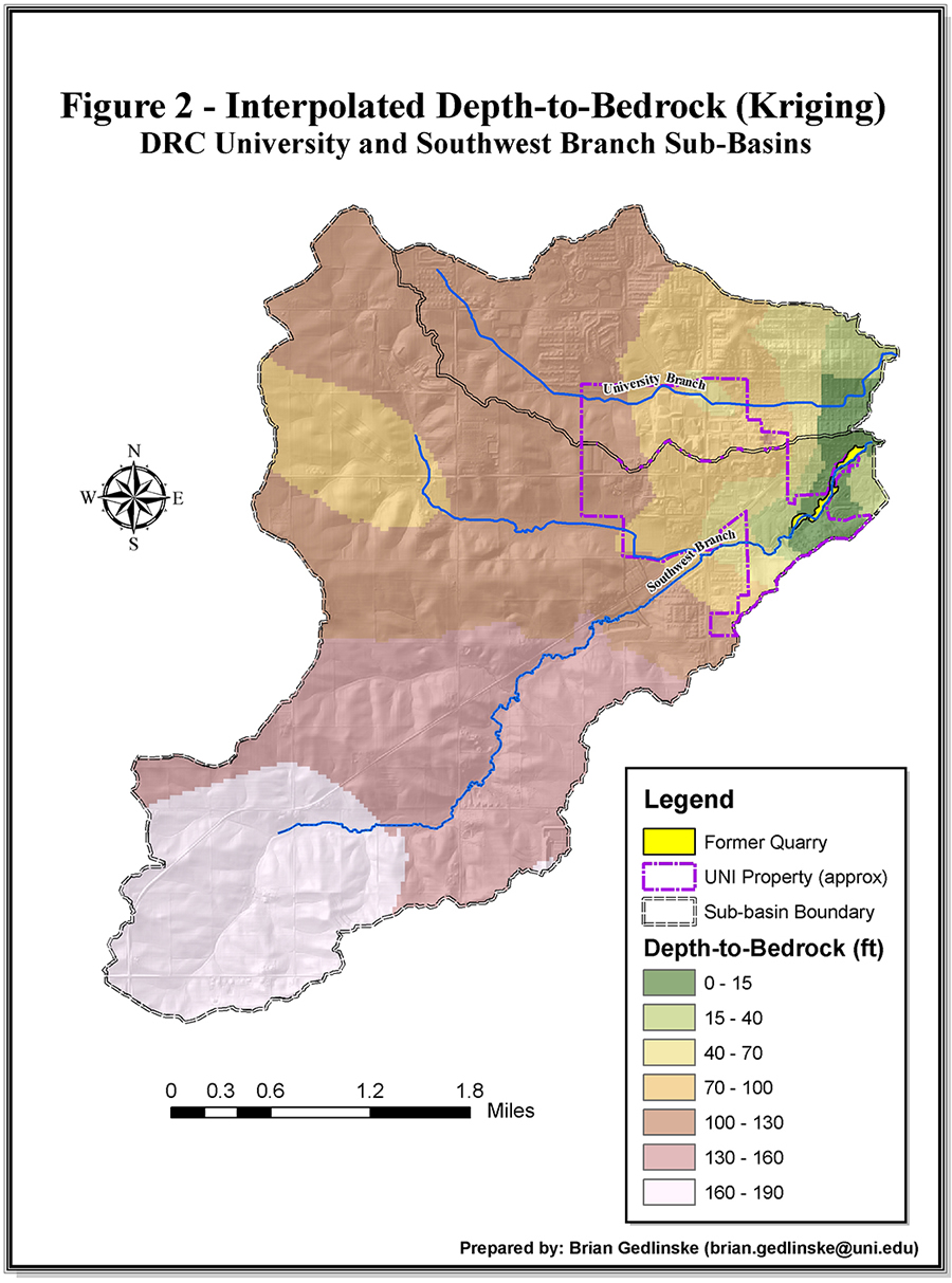

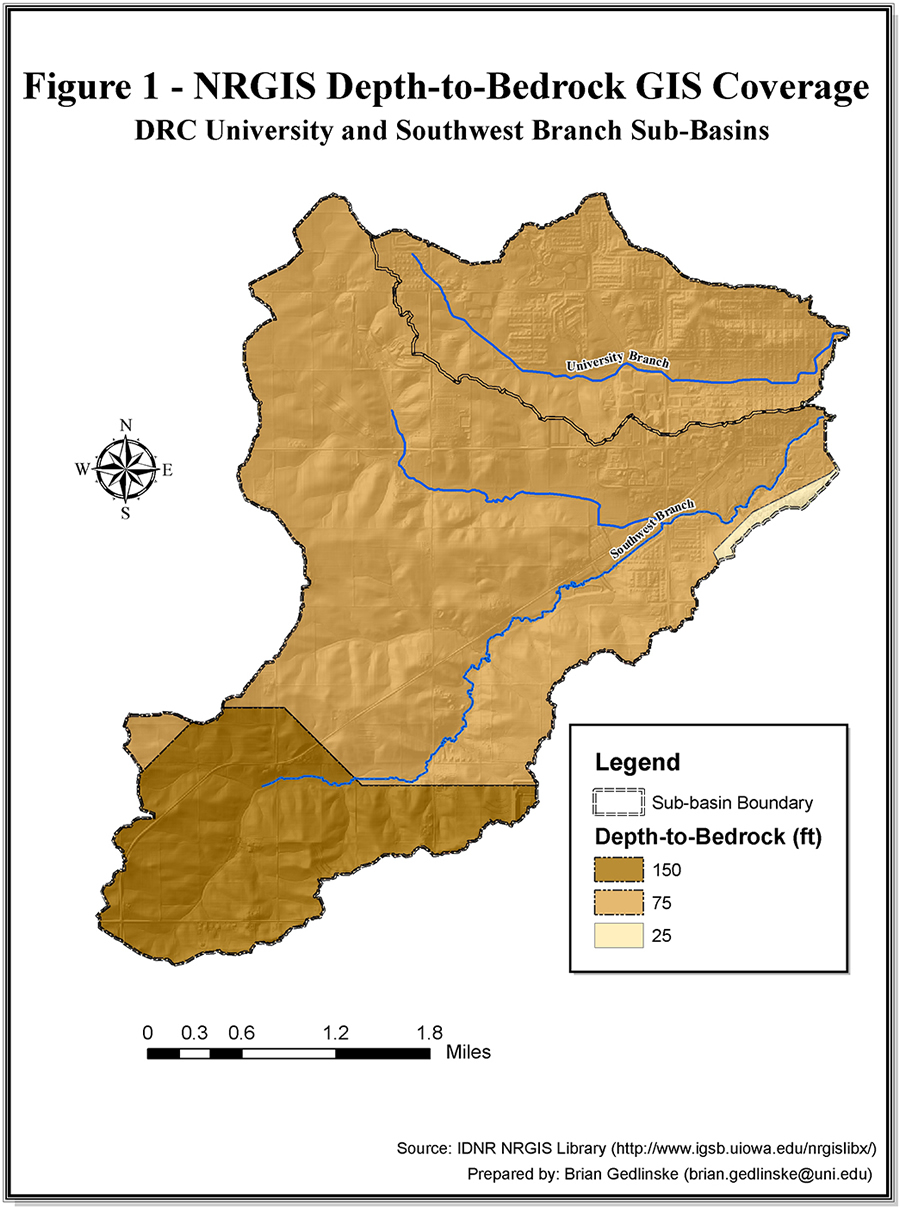

As the thickness of an overlying confining layer (in this case, till) is often the most critical indicator of aquifer susceptibility to surface contamination, the GIS effort focused on developing a detailed depth-to-bedrock map of the study area. For comparison purposes in demonstrating how generalized data can be improved, a depth-to-bedrock map was also developed for the area using existing digital, geographically referenced data obtained from the Natural Resources Geographic Information Systems Library at Iowa Department of Natural Resources. This generalized GIS data suggests that the more ancient (Devonian) bedrock depth ranges from 25 to 150 feet across the study site, with 99 percent of the area overlain by at least 75 feet of more recent (Quaternary) deposits.
The depth-to-bedrock map subsequently generated for the area.
This illustrates the depth-to-bedrock map subsequently generated for the area. As shown, it conveys a dramatically different message in regard to aquifer susceptibility.

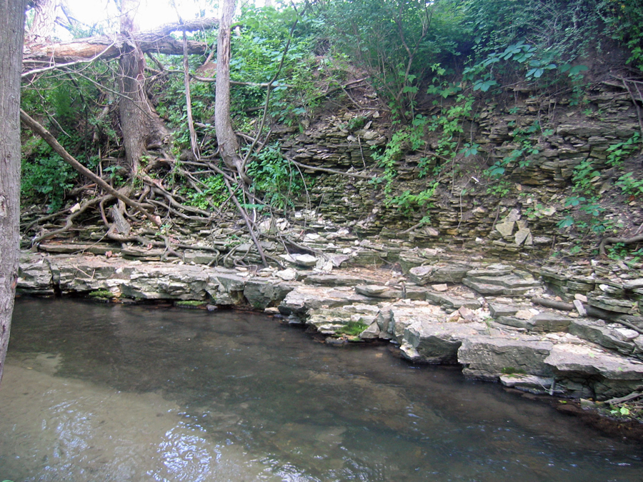

To develop an accurate depth-to-bedrock portrayal of the study area, a more detailed dataset was compiled for the area. Water-well drilling logs and boring logs associated with monitoring well installations that have been completed as part of environmental investigations were mined for pertinent data on the area's stratigraphy, hydrogeological characteristics, and specific yield information. Workers also performed a thorough review of historical literature. This review revealed significant but apparently forgotten or unrealized characteristics of the area including the presence of limestone (karst) swallow holes and bedrock quarry sites along the DRC channel. Finally, secondary data sources were complemented with GPS field mapping of significant features (i.e., well locations and bedrock exposures) found within the study area.
The effort to construct a more accurate depth-to-bedrock representation of the area relied extensively on ArcGIS to compile information, interpolate data, and illustrate the findings. This representation conveys a dramatically different message with regard to aquifer susceptibility. Data interpolation identifies a broad ridge of shallow bedrock along the DRC's Southwest Branch, a representation consistent with the bedrock exposures observed along the stream channel southeast of UNI's campus. Shallow bedrock, historical descriptions of the DRC as an ephemeral stream (caused by karst swallow holes), and groundwater-surface water elevation comparisons indicate a strong hydraulic connection between the DRC and the aquifer. Although a century of hydrologic alterations to the watershed (e.g., urban runoff, agricultural practices, cooling water discharge, and anthropogenic stream channel modifications) have transformed the DRC from a disappearing stream to a perennial tributary of the Cedar River, the aquifer undoubtedly remains more susceptible to surface contamination than typically alluded to in existing literature and generalized GIS datasets.
