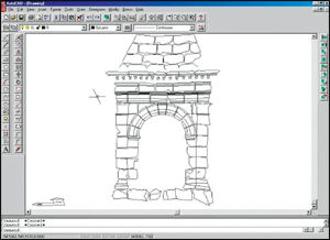

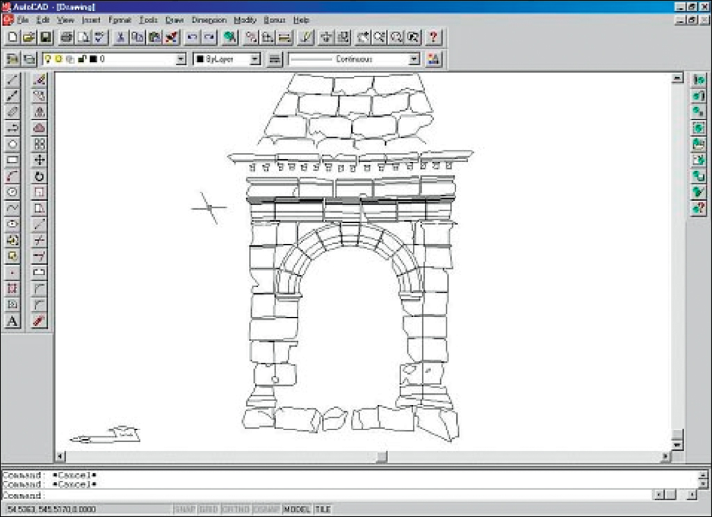

Historical graves in the excavation site were measured and evaluated by using close-range photogrammetric methods. A polygon network was established around the mausoleum to obtain the photogrammetric measurements of the pyramidal-roofed mausoleum. About 20 points on the surface of the mausoleum were determined with the aid of the polygons, and these points were coordinated by the method of estimation. The Sokkia PowerSet 2000 instrument was used to measure the mausoleum. The pictures were taken with a digital camera from five or six points to form a model. These pictures were stored in the computer and evaluated using PhotoModeler 3.0, and then the drawings were obtained in DXF format.
Once the collected data was assembled in the laboratory, the following procedure ensued:
  • First, the values of x, y, and z detail points, which were obtained during the site measuring, were calculated. The rough measurements of the site were obtained in DXF format and then converted into ArcView shapefiles. Thus, the graphic structure of the site was obtained.

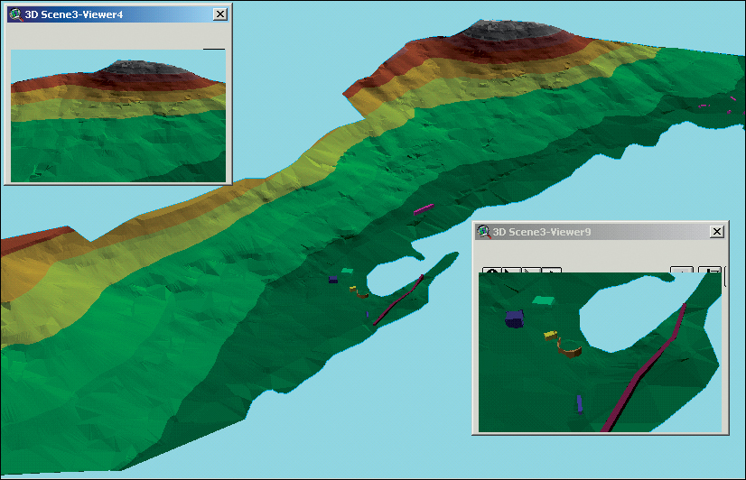

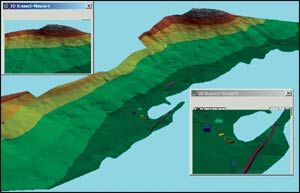

  • Finally, seven pieces of the construction maps of the area in 1:1,000 scale, including the excavation site, were scanned in JPEG format and stored. These maps were digitized in ArcView, and the ArcView 3D Analyst extension was used to obtain a 3D digital terrain model of the study area. The historical structural details obtained in geodesic measurements were added to this digital terrain model.
