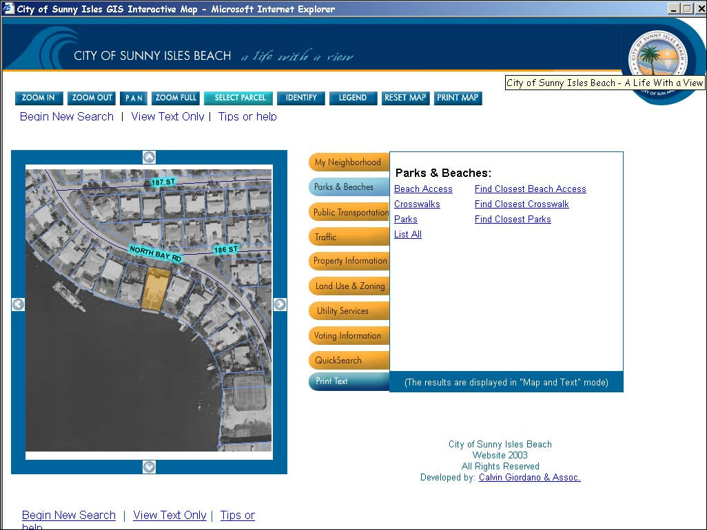

The long-term goal for this project is to keep end-users in mind and not bombard them with too much information, but rather to develop an intuitive and user-friendly interface. A categorization system was developed through the use of tabs (categories) sorting all the data pertinent to the selected property.

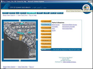

In order to orient the end-user with the amenities in the area, one of the features embedded in the application allows the user to find closest points (e.g., Bookmobiles, Beach Access, Crosswalks, Shuttle Stops, Bus Benches) from any parcel selected, taking full advantage of accessing the data in SQL server and calculating the distance using a mathematical formula utilizing the x,y coordinates of all features involved in the query.

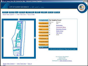

CGA combined the power of ArcIMS, ArcSDE, and Web development to classify and present the information for all users including non-GIS users. The geographic map interface includes buttons to zoom, pan, select, identify, and print a map at any point. After a parcel is selected, the system displays data in a text frame showing only information pertaining to the selected record. The application utilizes tabs (i.e., categories) to present information in a very intuitive manner. The tabs approach displays information grouped by My Neighborhood, Parks and Beaches, Public Information, Property Information, Land Use and Zoning, Traffic, Utility Services, Voting Information, or Quick Search. The Quick Search tab offers another way for users to quickly find information.
As another option, a text only version was developed, taking into consideration dial-up connections and providing the same functionality and information but without displaying it graphically on a map. When entering the Web application, the user chooses a controlled query or an entire city search. The user can type a complete or partial address, folio, or owner's last name. Then, from the built-in paging mechanism, the user can select from a drill-down list and browse information classified in the tabs. One feature embedded in the application allows the user to find within milliseconds the closest points (bookmobiles or beach access, for example) from any parcel, taking full advantage of data in the SQL Server and calculating the distance using a mathematical formula utilizing the x,y coordinates of all features in the query.
