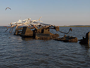

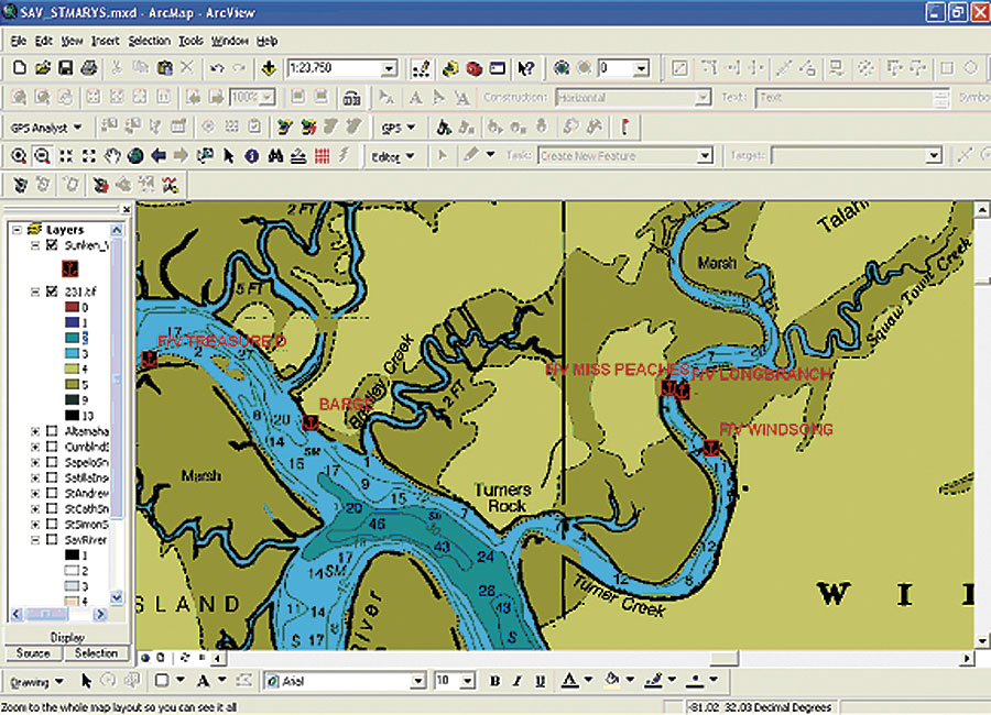

Because of the large size of the TIFF files, staff members uploaded only those sections of coastal county maps necessary to conduct the survey of the project waterway. After collecting the data, staff members would download the updated point shapefiles into ArcGIS Desktop software at the office. A two-gigabyte secure digital card was added to the Pocket PC to enable the use of additional TIFF files. Photographs or side-scan sonar images were made of various wrecks to be used on the Web site to allow boaters to see the water hazard as it exists. Because some of the derelict vessels have sunk in deep water and are not exposed, side-scan images are being used to enhance wreck site awareness. These digital photos are accessible via a link on the ArcIMS software-based Web site (www.gadnr.org). Additional information, such as impact to marsh vegetation from the vessel itself or from fuel and oil leaks, will be collected. This information will be analyzed using ArcGIS Desktop software and available on the site to staff making decisions regarding the removal of these derelict nonhistoric wrecks. The site also will include a description of the marine debris, the location, and condition. The handheld Trimble GeoXH Pocket PC allowed staff to quickly collect the GPS coordinates, log the information, and move to the next subject location. The Coastal Resources Division plans to continue to use the mobile GIS and georeferenced photographs in its fieldwork. This handheld technology significantly reduced the in-the-field mapping time and has created much more accurate information than could have been achieved with manual field mapping methods or simply utilizing georeferenced aerial photographs alone. Through the use of newspaper articles, departmental publications, and personal contacts, the State of Georgia has also recruited local boaters and charter fishermen to help identify additional wrecks or derelict vessels. The general public can access the sunken vessel data through the Georgia Department of Natural Resources Web site. The site will be updated regularly to add or remove derelict and sunken vessels. The project assists staff, local governments, and possibly federal agencies in assessing marine debris as it relates to navigation, fishing, and environmental impacts. About the AuthorCharles "Buck" Bennett has been employed by the State of Georgia for 18 years. He served as the Habitat Program manager and most recently as the Compliance and Enforcement manager for the Coastal Resources Division, Georgia Department of Natural Resources, in Brunswick, Georgia. He gained most of his experience in using georeferenced software and global positioning systems while serving in the military during deployments to Bosnia and Iraq. More InformationFor more information, contact Charles "Buck" Bennett, Compliance and Enforcement manager, Coastal Resources Division, Georgia Department of Natural Resources (tel.: 912-264-7218, e-mail: buck_bennett@dnr.state.ga.us). This application, along with those from other grant winners, is available on Esri's public domain Web site at www.esri.com/arcscripts. |
