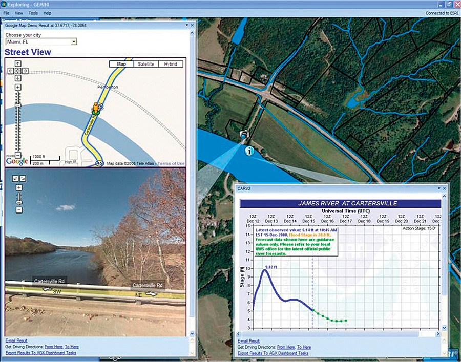

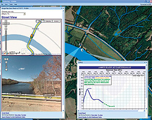

Emergency managers are interested in monitoring the stage height of the James River at a USGS stream monitoring station.
General scenario or mission-specific tasks for the software, written in C#, .NET, and Python, can be compiled with preloaded data layers and shared easily (via e-mail) with other emergency managers. Tasks can be chained together to solve relevant emergency management business problems. A buffer task, for example, will generate output given certain input (e.g., a point location and distance parameter). The results from this task (i.e., buffer shape) can be passed to an intersect task to determine the parcels, addresses, and landowners potentially affected by an event within the buffer area.
