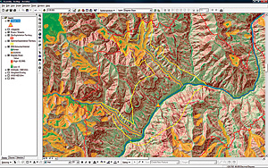

The analysis output for a single village. The site exploitation territory is in red and the optimal exploitation territory in yellow. Degrees slope and forest/ecotone habitat are overlaid on a 10-meter hillshade.

To examine the quality of hunting grounds in the landscape surrounding known winter village sites, the researchers modeled the relative influence of game habitat productivity and topographic relief on hunting payoff-related movement within village site exploitation territories. The analysis involved three primary steps and was repeated for each village site in the sample population. For comparison, the procedure was also applied to nonvillage locations.
To begin the analysis, the site exploitation territory was developed using an isotropic friction surface derived from a U.S. Geological Survey National Elevation Dataset 10-meter digital elevation model. With Raster Calculator in ArcGIS Spatial Analyst, this friction surface was input into a cost-distance formula with a known village site as the starting point. This produced a site exploitation territory extending the work equivalent of 10 kilometers from the site (assumed to be the maximum allowable distance traveled from a village during daily foraging activities).
The second part of the analysis involved a weighted overlay grid developed in ModelBuilder. This grid was used to create a friction surface in which resistance is a function of potential hunting success dependent on habitat type and topographic relief, with greater success and lower relief offering the least resistance.

Finally, the weighted overlay cost surface and village site were put into a cost-distance formula in Raster Calculator to identify the optimal exploitation area within the site exploitation territory and calculate the total accumulative cost of traveling from the village site to the boundary of the site exploitation territory along least-cost (highest payoff) routes. In the optimal exploitation area, every cell is assigned a value representing the accumulative cost to reach that cell from the village along the least-cost path within the site exploitation territory. The optimal exploitation territory provides a visual representation of the direction and distance most likely to be traveled by hunters from the village during a single day. The total accumulative cost provides a relative index of the quality of ungulate habitat and steepness of terrain occurring along the least-cost trajectories within the daily foraging radius of a site.
