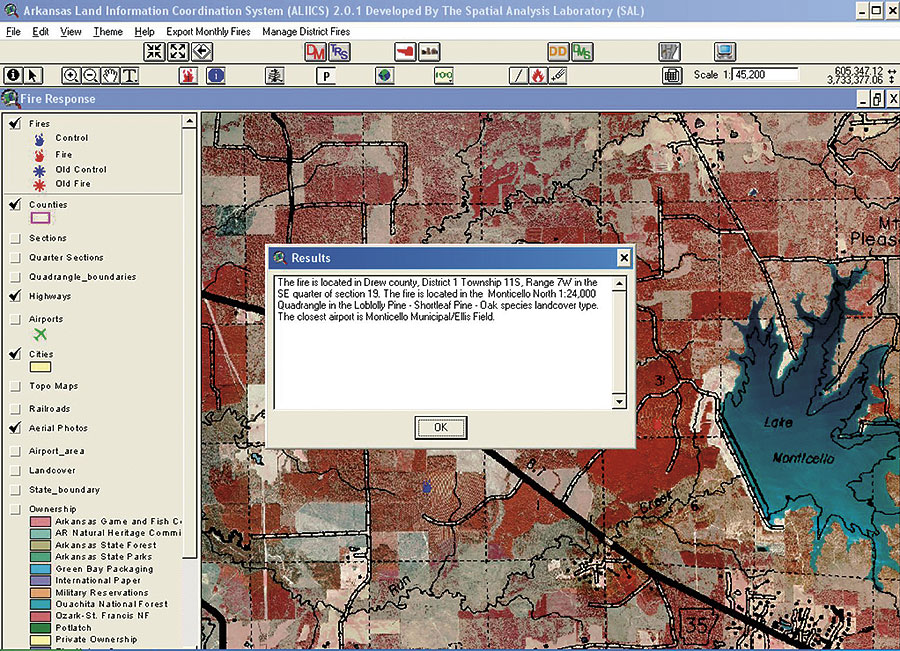

  click to enlarge
This image shows dispatched fire information.

Recently, the Spatial Analysis Laboratory developed a more efficient forest fire dispatch program using ArcView. ArcView was selected because it doesn't demand excessive processing power, is easily customizable, and meets the needs for dispatching fire response personnel. Moreover, the customized application doesn't require a GIS expert to use it. The Fire Program is composed of 15 data layers, including jurisdiction boundaries, highway maps, airport locations, topography, and one-meter color-infrared aerial photography. When a dispatcher receives a call, the fire can be located three different ways: by latitude and longitude; township, range, and section; or user point.
When a pilot radios in the latitude and longitude of a fire, it now takes the dispatcher approximately 10 seconds, as opposed to 10 minutes, to determine not only the township, range, and section of a map but also a wealth of information derived from the 15 different data layers that were not available in the past. After the latitude and longitude are known, the dispatcher simply selects the Add Fire by Latitude-Longitude button and enters the information. The dispatcher is then prompted to enter an incident number and the name of the fire.
Now dispatchers have vital information at their fingertips in the form of a small "results" window, including county, district, township, range, section, quad name, land-cover type, and the closest airport. Once the fire is entered in the database and centered in the view, the dispatcher has 15 data layers to display and query.
