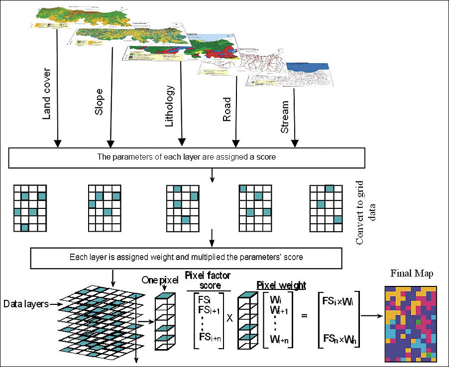

A GIS analysis has been conducted in Trabzon province to determine potential landslide areas. Since the province covers a large area (4,660 square kilometers), the study is largely dependent on spatial data. Many parameters and methods of assessment exist, but there is little agreement in the literature as to which factors should be included in the determination of risky landslide areas. However, in detailed studies, the number of factors can be increased depending on the study area characteristics. For the purposes of this study, topography, lithology, land use, and stream and road networks were considered, and the Weighted Linear Method was applied to determine hazardous landslide areas. ArcInfo and ArcView were used because of easy access and viewing of data, high storage capacity, and quick analysis. The data layers belonging to selected factors were obtained from different public organizations as paper maps and were digitized within the ArcInfo environment. Following digitization, these layers were converted into 100-meter grid formats using ArcInfo commands. Scoring Potential

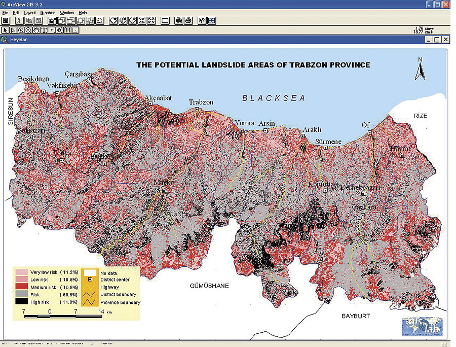

Factor scores were determined based on a 0100 scale range. On this scale, high scores represented low landslide risk while low scores represented high landslide risk. Factor weights were determined in a similar approach, and each factor was scored relative to the other factors on a 0100 scale. The accompanying table presents the factor scores and weights used. The slope was accepted as the most important factor because of its impact on the landslide. Therefore, the slope factor was given the highest weight. After determining the factor scores and weights, they were multiplied by each other using ArcView software's map calculator submenu under the Analysis menu to obtain pixel scores. Then these pixel scores were added to each other, and finally, the pixel scores were evaluated and a potential landslide map was produced in five classes: very low risk, low risk, medium risk, high risk, and very high risk. Analysis shows that high-risk areas, covering 62.4 percent of the province, are dominant. Only 21.7 percent of the provincetypically close to the coastline where a flat topography is frequently the normis without landslide risk. To examine landslide risk in villages, maps of both landslide potential and settlement areas are overlaid. This study shows the number of settlements with respect to the potential landslide classes. According to these results, 56 possible settlement areas are considered very high risk while 227 are high risk. In other words, 51 percent of the villages in Trabzon are under landslide risk. This work was done at the GIS Research Lab (GISLab), which has provided GIS services at Karadeniz Technical University since 1995. The ArcGIS framework has enabled setup of spatial analysis functionality for complex environmental solutions tasks. For more information, contact Selcuk Reis, Department of Geodesy and Photogrammetry, Nigde University, Aksaray, Turkey (e-mail: sreis@nigde.edu.tr, tel.: 9-0382-2150953, fax: 9-0382-2150592), and Tahsin Yomralioglu, Geodesy and Photogrammetry, GISLab, Karadeniz Technical University, Trabzon, Turkey (e-mail: tahsin@ktu.edu.tr, tel.: 9-0462-3772793, fax: 90-462-3280918, Web: www.jeodezi.ktu.edu.tr/tahsin). |
