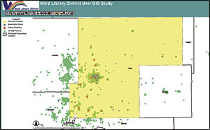

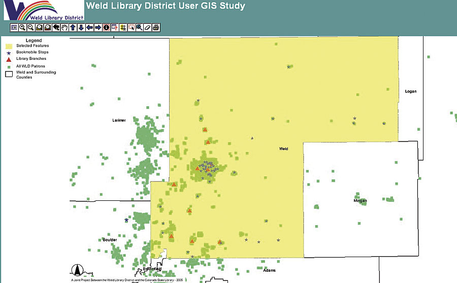

The distribution of registered users at the Weld Library District shows use both inside and outside of the district.
The Networking and Resource Sharing Unit of the Colorado State Library has worked with public libraries in Colorado to create GIS mapping projects that show the distribution of their library users in relation to geographic features, such as branch locations and book mobiles, since 2003. In 2005, mapping projects were created for five public libraries in Colorado. These projects allow the decision makers at the libraries to take a geospatial approach to understanding their community demographics, analyze library use patterns, explain statistical trends, and assist in making management decisions.

Case Study: GIS at Weld Library District
The Weld Library District (WLD) and the Colorado State Library began working on a GIS mapping project in late 2004. A final version of the project became available in mid-2005.
WLD serves the 230,000 residents of Weld County and covers a geographic area of almost 4,000 square miles. Currently, WLD has 110,000 registered users, or about 48 percent of the population. Weld County has been predominantly a rural, agricultural area, but a number of factors have converged to create a growing population in a booming housing market and new job opportunities.
The use of the GIS mapping project at WLD focuses on three areas—marketing, service delivery planning, and governance.
Marketing—WLD has a stated goal that every resident of the district will use library services at least once a year. Mapping data is used to locate census demographic information that includes age, sex, and language, which is then compared with the library user data that identifies the same characteristics. This pinpoints areas in the district where the marketing penetration goals are falling short. For example, in a rural area in the northeast quadrant of the district, census tract 2501 contains 3,681 people, two-thirds of whom are adults. There are several bookmobile stops in this area. When the census data is compared to the library user data, approximately 1,000 individuals with borrower cards are identified, and two-thirds of these borrowers are children under the age of 18. Therefore, most adults in the area don't use the libraries, and this population segment has been targeted for future marketing studies to best determine how to serve the adult residents.
Service Delivery Planning—The policy of the Library Board is that new library facilities should be positioned at least five miles apart. Using GIS mapping data and in cooperation with the Weld County Planning Office, maps were constructed to identify areas that lie outside of the five-mile radius of an existing facility. In one area, 1,000 people, most of whom are over the age of 40, were identified. The GIS mapping project shows that 60 percent of those residents have library cards and are active patrons of a library that is five miles or more away. The conclusion of the library is that the area is being served adequately. In another area of 3,200 people, 661 library users are shown, most of whom are children registered as bookmobile users. The conclusion is that the area is not being adequately served by the district, and alternatives are being considered.
Governance—Another map prepared for the Library Board illustrates the WLD library users who reside outside the district. The GIS mapping project provides a graphic presentation of the fact that almost 10 percent of the users are residents of neighboring counties. Several neighboring library districts have done similar studies to identify how many WLD residents use their libraries. Together, the maps illustrate both the fluid boundaries between nearby public libraries and demonstrate the statewide commitment to resource sharing in action.
