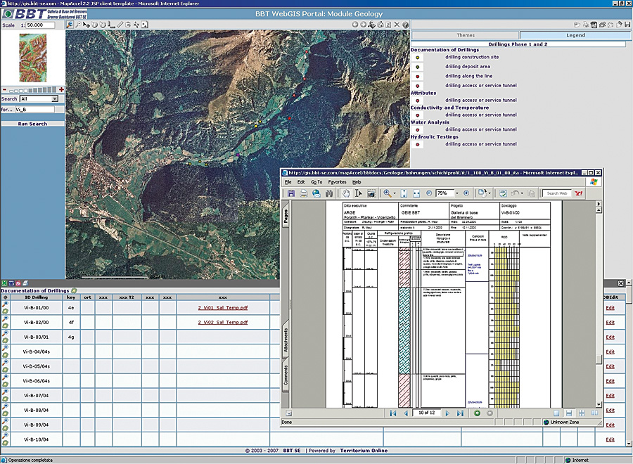

  click to enlarge
Geology module shown with a linked document that the user can easily access.

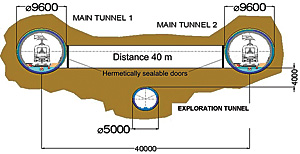

The Galleria di Base del Brennero—Brenner Basistunnel (BBT SE) is the European public limited company entrusted with the design and construction of the Brenner Base Tunnel, considered to be the core of the European railway axis from Berlin to Palermo. The project is composed of two main tunnels connected every 336 meters by transverse tunnels for safety and maintenance purposes, as well as a third tunnel used for exploration purposes.

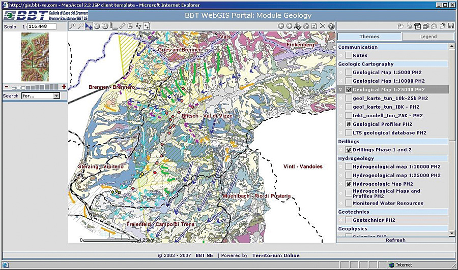

  click to enlarge
Geological and hydrogeological data is displayed in the Geology module.

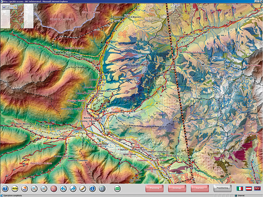

The GIS applications developed are divided into two primary tiers. The internal GIS application is used by BBT SE engineers for project planning and development. The external application is for use by the general public so that they can easily follow the progress of the project. The multilanguage applications are structured in one public and five internal views. All are derived from a single master view.
The system is thus composed of six thematic modules and constitutes the core of the BBT SE GIS architecture. The modules include geology, planning, water monitoring, topography, land parcels and owners, and the public module. Data access is provided according to authorization and restriction, as well as the need for specific functionality. Data access control and access rights must be enforced because the project uses some data that is considered sensitive. Therefore, it is necessary to implement some restrictions regarding viewing and editing capabilities not only for security reasons but also to minimize the chance of introducing errors into the database.

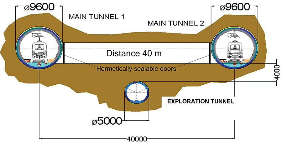

  click to enlarge
Cross section of the Brenner Base Tunnel design, depicting the main and exploration tunnels.
