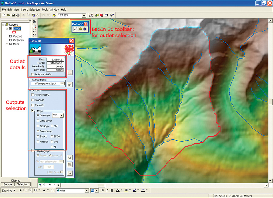

This image shows the BaSIn 30 ArcGIS Desktop extension interface elements.

As part of the IHR project, the Basin System Information of Department 30 (BaSIn 30) application was designed to simplify the extraction, at the watershed level, of the most relevant information for the purpose of planning new hydraulic structures.
Since most of the department's flood managers were already familiar with the ArcGIS Desktop software platform, BaSIn 30 was implemented as an ArcGIS Desktop extension. The input data required by BaSIn 30 is all spatial and includes general layers about land use, geology, and morphology and more specific layers about the hydrologic network, hydraulic structures already in place, and hydrologic hazards.
Using BaSIn 30
When a user in Department 30 has selected a suitable outlet, on the basis of a digital elevation model (DEM), BaSIn 30 extracts the divide of the watershed and visualizes it. At that point, the user can select the desired outputs, and BaSIn 30 clips the required input layers based on the watershed divide. Then, the clipped layers are processed to extract the information required to produce the desired reports.

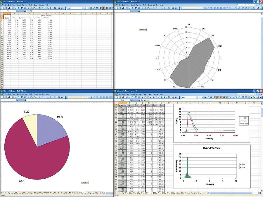

A selection of BaSIn 30 output spreadsheets reporting about various characteristics of the watershed being investigated: elevation, slope, geology, hydrological response.
At the second level, outputs include several Microsoft Excel spreadsheets containing both a selection of level-one outputs and extra information in the form of mainly statistics and charts. At this level, the outputs are already structured enough to be immediately utilized by managers.
