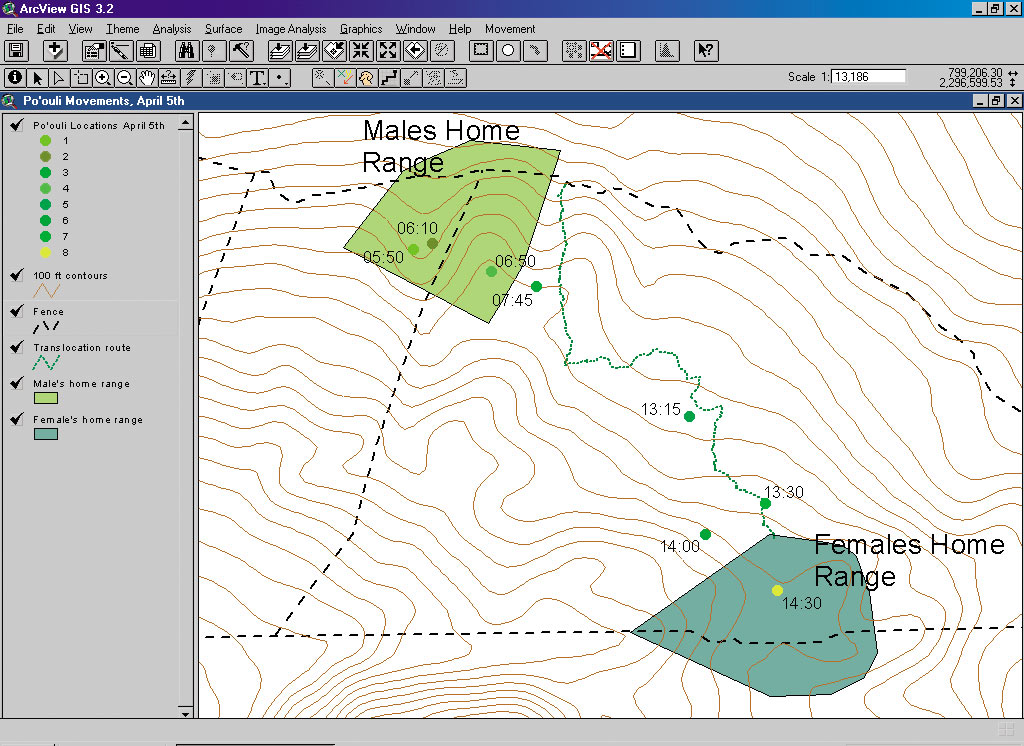

This map shows the two Po'ouli home ranges and triangulated positions of the female Po'ouli as she made her way home after release.

Again, the team used home range maps created from the female's resight history to help place mist nets in the female's territory. The team was concerned about the female's well-being because she had not been seen for more than eight months. However, luck was on their side; after 12 days, the female was caught. After taking a few quick measurements, the team placed her in a transport container and hiked 2.5 kilometers to the male's home range. After a one hour and 15-minute hike, the team fitted the bird with a .8 gram radio transmitter and placed her in a holding cage where she could be monitored prior to release. After the team rechecked the transmitter signal and receiver frequencies, they carried the female into the male's home range. Despite focused effort, the male could not be found. So the team decided to release the female based on kernel analysis of dusk sightings of the bird during the previous three weeks. Upon release, the female was radio tracked after sunset to determine whether or not she roosted in the male's territory overnight. Previous translocation and release work with other species indicated that there was a high probability that she would immediately fly back to her home range.
The following morning radio tracking began before dawn. The female's signal was still being received in the male's home range, but shortly after sunrise she began to move. Telemetry results show that the female stayed in the male's home range until approximately 10:00 a.m. Throughout the rest of the day, however, radio tracking confirmed that she was heading directly back to her own territory. The radio tracking team managed to track her progress and was able to triangulate her position several times during her return. Within 24 hours of her capture, the female Po'ouli was back in her original home range, covering a distance of more than 1.7 kilometers and an elevation gain of greater than 1,000 feet. There was no indication that the two birds ever came into contact with each other.
