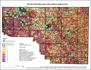

This is the completed map the Eureka Springs EAST group gave to the emergency personnel of Carroll County: Slope data is included to give an idea of where the flat areas are (slopes 0–5 percent, which are ideal for helicopter landing sites).

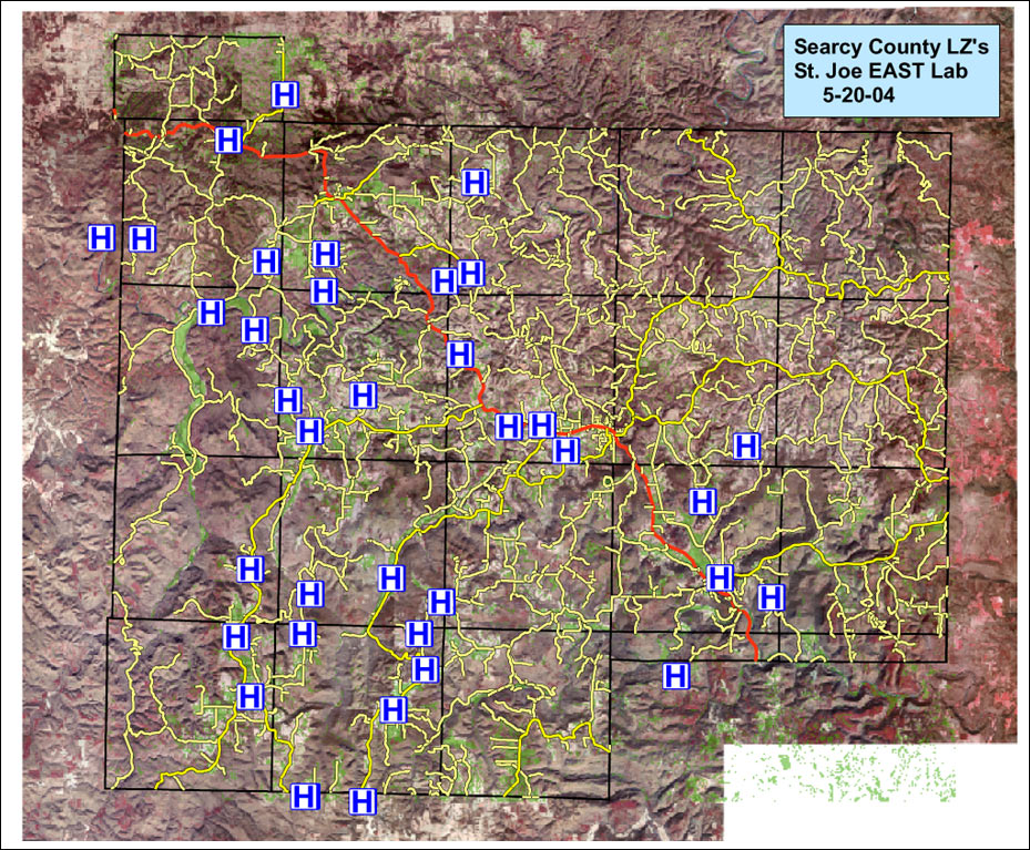

This map details the helicopter landing sites for Searcy County as created by the St. Joe EAST students. The landing zone project consisted of five monthly conferences funded by the Winthrop Rockefeller Foundation that enabled all the EAST students from the four schools to help each other.
