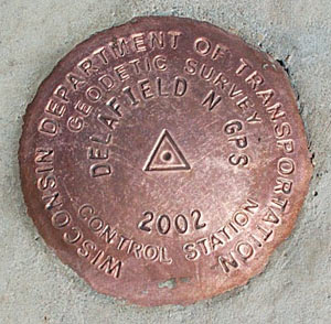

The geodetic reference system is a network of substantial, stable physical structures, each of which includes a disk that provides information on the agency that put the geodetic monument in place, the name of the monument, and sometimes the date the monument was set. These monuments are typically concrete pillars set in the ground or rods driven deep in the earth. More recently, some geodetic monuments have included a GPS antenna and receiver for collecting a continuous stream of data about the monuments' location. At the second annual Esri Survey and GIS Summit last summer, Charlie Challstrom, director of the National Geodetic Survey, stressed the importance of the geodetic control foundation to provide the interdependent linkage among GIS data layers.

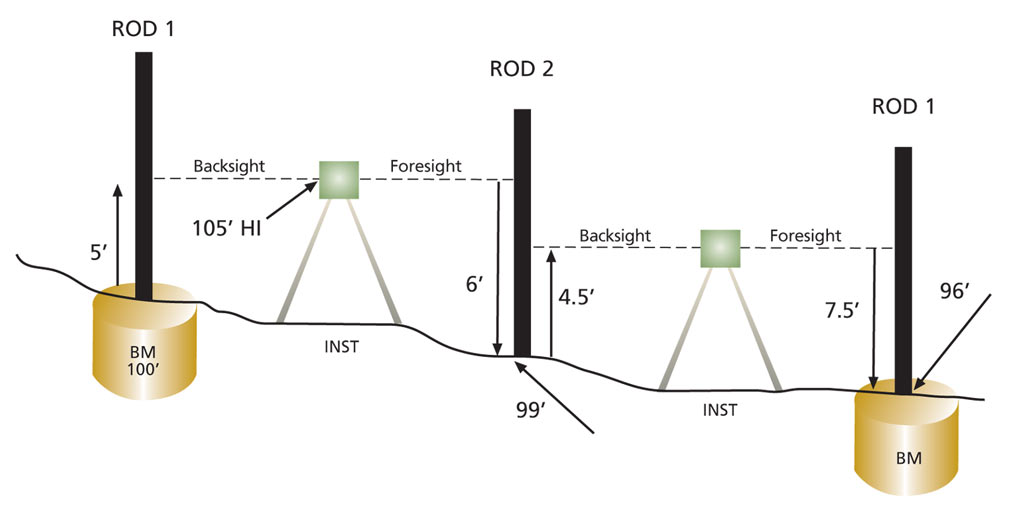

Conventional leveling techniques for elevation determination.

Geodetic survey control station dial.

Conventional leveling is the technique used to determine vertical coordinates for a series of monuments called bench marks. Bench marks are usually set in a series called a level line. Distances between bench marks along level lines are called sections. Traditionally level lines were set along transportation corridors, primarily railroad rights-of-way. In the WI-HMP, bench marks and GPS monuments are set in public rights-of-way and other public lands, such as parks, to the maximum extent possible. This helps assure that all users of the geodetic network will have ready access to the monuments for subsequent survey-related activities.
For the Wisconsin Height Modernization Program, bench marks are set at approximately 3 km (1.8 mile) intervals along level lines. Level lines in Wisconsin are spaced in a rough grid of approximately 25 kilometers, which "run through" and include key horizontal monuments for which highly accurate horizontal coordinates have previously been determined using GPS.
Procedures to collect elevation (vertical coordinate) data for sections of a level line have changed very little since the early 1900s (see drawing). In the simplest case, graduated vertical rods (calibrated for accuracy) are set up along a level line with rod 1 on a bench mark (with a known elevation) and rod 2 on a temporary mark (e.g., metal pin driven in the ground). The level instrument is set halfway between these two rods. The first reading is taken on rod 1 (backsight), and that value is added to the height of the bench mark to determine the height of the line of sight of the instrument. Then the instrument is turned, and a reading is taken on rod 2 (foresight); that value is subtracted from the height of the instrument to determine the height of the temporary mark. The instrument and rod 1 are then moved ahead, making rod 2 the backsight and rod 1 the foresight. This procedure (backsight–foresight) is continued along the section until another permanent bench mark is reached. All sections of a level line are observed in this fashion and must be observed twice (in opposite directions) to assure that no measurement errors have been made. Current leveling procedures use bar coded rods (similar to Universal Product Code scanning by retail stores), and the instruments take multiple shots for each measurement.

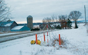

Winter fieldwork in Wisconsin demonstrates the wide capability of GPS technology.
