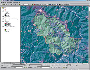

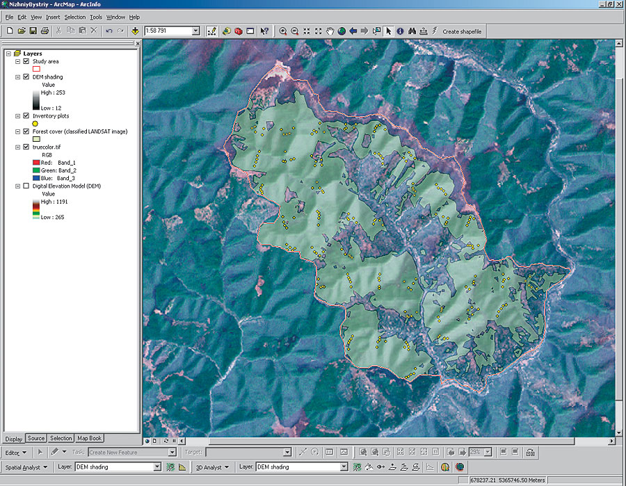

IFER created the border of the watershed from a Shuttle Radar Topography Mission (SRTM) digital elevation model (DEM) using the hydrological functions of ArcInfo. The forest area was derived from Landsat satellite imagery. They classified the imagery by combining supervised and unsupervised classification methods with ArcInfo. Using these methods, it was possible to get basic information about the study area even before coming to the Ukraine.
IFER performed the SFI measurements on a large number of relatively small inventory plots. The network of SFI plots was designed to representatively cover the area, but at the same time, the plots needed to be accessed with minimal time loss. They used ARC Macro Language (AML) script to create a network of SFI plots using ArcInfo. Plots were grouped in clusters of five, and these clusters, which covered local altitude gradient, were equally distributed in the forested area of the watershed. Each cluster represented one day of work for one field team.

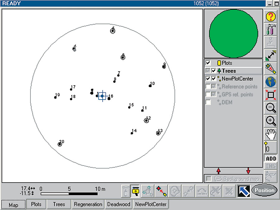

GIS-based application FieldMap has been designed for data collection on sample plots.
IFER visited 200 plots during the field campaign, subjecting 2,249 trees to detailed biometrical measurements. Using field map technology, they stored the field team data in shapefiles directly in the field. Thus, the office work was reduced to downloading the data and recharging the batteries.
