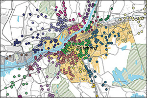

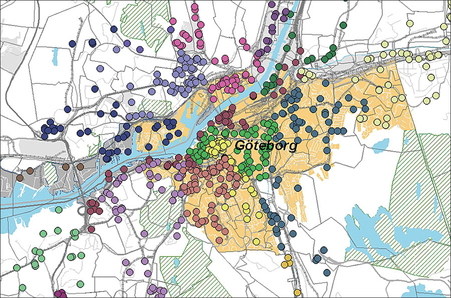

Overview map showing planned deliveries in the town of Gothenburg, Sweden.

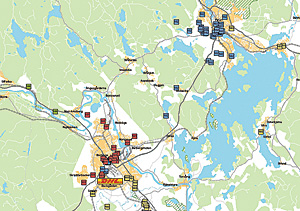

Work began with a pilot project conducted at the terminal in the Dalarna region in central Sweden. The goals were to obtain experience and measure the actual time gained. With a map sheet used as a foundation, Dalarna was divided into a grid, with each address receiving a unique number. The goods arrived at the terminal at night. Each parcel was then scanned with a bar code scanner and assigned a serial number, which showed both the vehicle it was to be loaded into and the location of the vehicle. When the drivers arrived in the morning, they each received a list with their driving schedules, load orders, and the goods that had already undergone preliminary sorting. The drivers' knowledge of local conditions was put to use when the system was built. The pilot project in Dalarna constituted the basis for the DHL Express GIS solution as it is today.
  click to enlarge
Overview map showing planned deliveries in the towns of Falun and Borlänge.
The Esri S-GROUP tool developed for DHL Express is called Distribution Control. The core of Distribution Control is ArcGIS Server software, based on a SQL database. ArcGIS Server is used to assign geocodes and sequences for incoming items. The ArcGIS Server solution links the items to the map and the correct grid and assigns a delivery order. With this procedure, DHL Express minimizes the time drivers spend at the terminals to load their vehicles, freeing more time for driving and making deliveries. ArcGIS Server has become a necessity for DHL drivers to load their vehicles and depart from the terminals more quickly.
