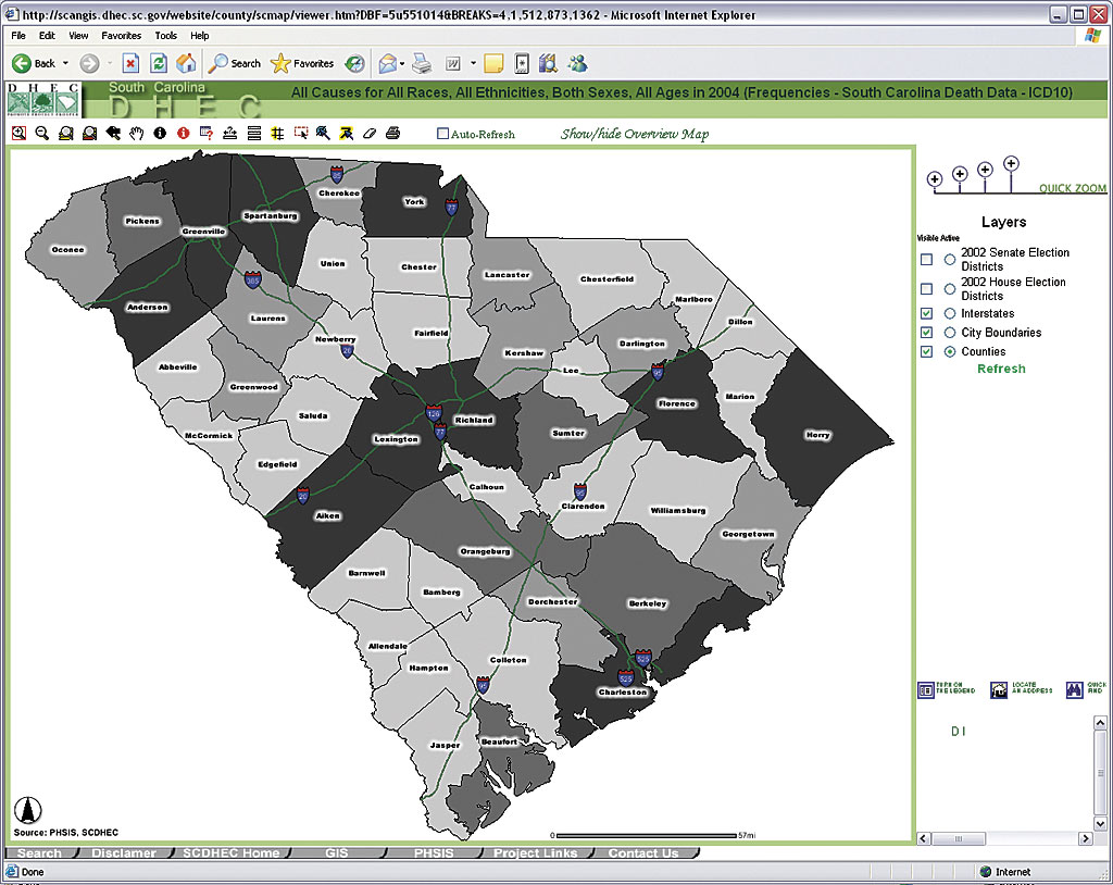

click to enlarge
The division's server-based GIS combines GIS Web publishing using both standard and customized Internet map services.

One solution was to implement a server-based GIS that could cope with all the above concerns. Server-based GIS can be defined as centrally hosted GIS computing. Internal GIS capabilities are shared with users on the agency network while a Web-based platform is also maintained for external users. GIS users have the capabilities to connect to the central GIS servers using desktop GIS software, Web browsers, custom applications, and mobile computing devices.
The division's server-based GIS is a combination of GIS Web publishing using both standard and customized Internet map services furnished using ArcIMS, ArcSDE with a relational database management system (Microsoft SQL Server) for data storage, and a centralized shared GIS server using ArcGIS Server. Additional components, extensions, and customized applications that consume GIS information are also a big part of the overall picture.

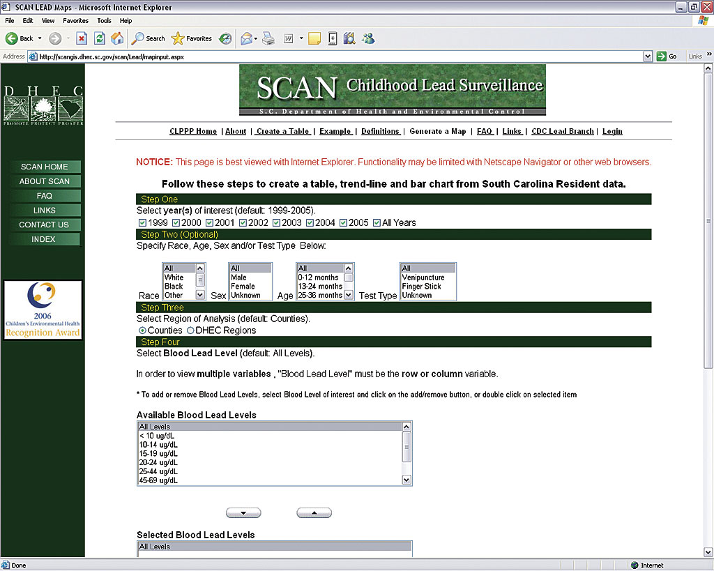

click to enlarge
South Carolina Assessment Network (SCAN), an application developed by the division, uses ArcIMS for Internet mapping, Microsoft SQL Server/ArcSDE for data management, ASP.NET and HTML for programming and interface design, and XML for data exchange.

Historically, most typical data requests for geospatial and tabular data are provided to DHEC through manual processes such as phone calls or on-site visits. Traditionally, these requests would be handled by office personnel. This would require intermediate steps, discussions, and, often multiple revisions before the final product was created. The advent and subsequent rise in Internet use opened new avenues for data requests as well as a whole new group of data requestors. Now, with the help of built-in functionalities and customized ArcIMS applications that use .NET technology, Java, and Active Server Pages (ASP), a user can generate custom maps and tables in real time. The data delivery mechanism is streamlined, user friendly, and cost-effective.
The South Carolina Assessment Network (SCAN), an application developed by the Public Health Informatics Division, uses ArcIMS for Internet mapping, Microsoft SQL Server/ArcSDE for data management, ASP.NET and HTML for programming and interface design, and XML for data exchange. Statistical and geographical results are generated on the fly using ASP.NET's built-in algorithms. Internet GIS allows users to drill into categories; modify requests; add spatial layers; and obtain supplemental information that includes animated formula calculations, help screens, and definitions. SCAN has significantly decreased the number of requests coming into the division while dramatically improving response time and data availability. This has enhanced the division's ability to answer more detailed requests and branch out into other areas such as homeland security, emergency response, and data collection/augmentation.
