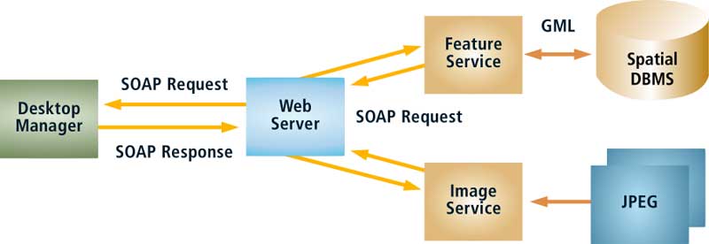

Figure 3: The work manager interaction with feature and image data services
Figure 3 shows the work manager interaction with feature and image data services. Typically, a work manager sends a SOAP request to a Java Web service to retrieve vector and raster data within a selected spatial extent. The Java Web service communicates with the database for vector data and ArcIMS for image data. The Java Web service returns vector data in GML and a raster image to the desktop application. The desktop application converts GML to shapefiles and overlays the image extracted from an ArcIMS image server. The work manager has been implemented in MapObjects—Java Edition.
