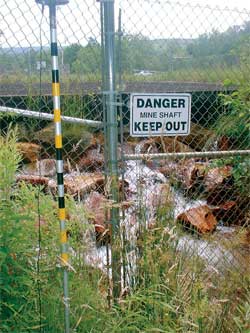

In 1993, highly acidic water gushed out of an abandoned mine killing an estimated 60,000 fish in the Casselman River. For many years, the Casselman River and its tributaries, located primarily in southern Somerset County, Pennsylvania, have been impacted by nonpoint pollution sources.
photo of discharges pollution
Discharges from abandoned mines have been a major source of nonpoint pollution in the Casselman River Watershed.

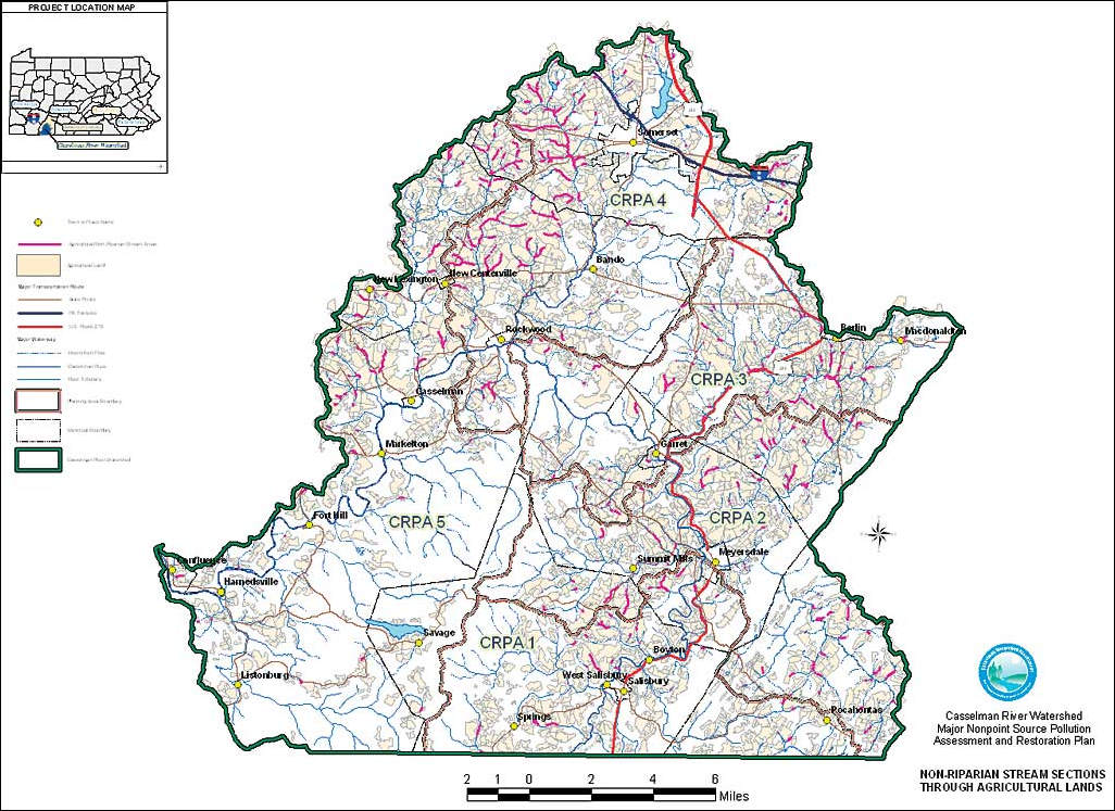

To identify areas with the highest potential for agricultural runoff, agricultural lands in the watershed were digitized. Stream stretches with inadequate riparian zones were digitized and added to the GIS to establish locations with high potential for agricultural runoff. This assessment focused on providing a planning tool for improving water quality in the Casselman River and its tributaries by reducing the impacts of agricultural nonpoint pollution sources. Information for three primary agricultural-related criterion—total acres of agricultural land, total length of stream bank with inadequate riparian buffer zones, and total length of stream bank with inadequate riparian buffer zones through agricultural land-and agricultural nonpoint source screening results were used to assign a high, medium, or low priority to each subwatershed within each planning area. GIS was instrumental in calculating the acreages and lengths for the primary agricultural criterion.
click to enlarge
In addition to mine discharges, the assessment was a tool for improving water quality by reducing the impacts of agricultural nonpoint pollution sources.
