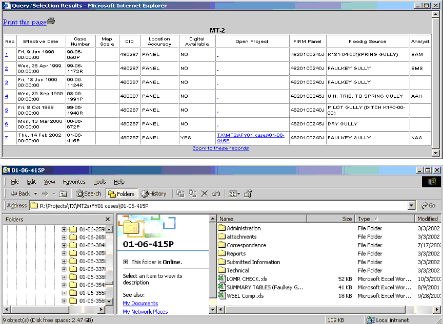

LOMA and LOMR Links
Once a LOMA or LOMR case has been selected, caseworkers can directly link to any scanned copies of any associated documents that reside on the local PBS&J network. This saves analysts time by eliminating the need to fill out library requests to obtain these documents. Currently, more than 1,200 LOMR and 5,500 LOMA cases are linked to digital data.
