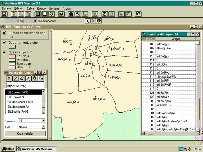

Working With GISTraditionally, survey results were collected in a form book that contained handwritten entries for words listed by phonetical and lexical criteria. These entries were eventually mapped by a cartographer. However, the introduction of GIS in 1996 changed these methods radically. After initial success using ArcView 1.0 and ArcExplorer, the INILFI began using ArcView 3.1 in 1999. Phonetical pictures are very important in linguistic geography. The phonetical transcription of a language requires a set of symbols different from those used in everyday written language. It requires a font with TrueType font phonetic characters that can be included in ArcView tables and displayed in a project view. SIL International (formerly known as Summer Institute of Linguistics) provides researchers with fonts for phonetic representation. These fonts can be downloaded from the SIL International Web site (www.sil.org). With these fonts, phonetic data can be included in tables using ASCII codes and data can be labeled using phonetic fonts. Using Scripts and Extensions in ArcView
Scripts and extensions downloaded from the Esri Web site provided solutions to several problems encountered during the project. Copy View, an Avenue script written by Fred J. Calef III that copies an existing view to a new view with a new name, was used to simplify the reproduction of maps with the same characteristics. For this project, 150 maps were needed for each subject area. To make map reading easier, each survey site was assigned a three-figure number. The Load and Save Graphic Text Labels extension provided by Esri was used to add labels for each location surveyed and display labels in the same position on every map generated. During the survey, which was conducted between 1996 and 2000, audio recordings were accumulated. The pronunciation of words used in context was captured. These recordings were used to compare and contrast the phonetic transcription of the linguist with recordings to make the most accurate transcription possible. In addition, the recordings collected ethnographic and anthropological information for a study to be published after the completion of the AleCuyo atlas. The Generic Hotlink script written by Ruth Bowers was used to hyperlink WAV and MP3 audio files to survey sites. The hyperlinked phonetic pictures provide not only the transcription of a word but also an audio fragment illustrating the word in context. The project also required extensive hyperlinking of images and text. To put all the information together, each survey site was hyperlinked to images, some in CAD format, that illustrated words and described the semantics of words. Text files containing the definitions of words were used with ethnographical and/or historic-geographical notes. Future Projects
