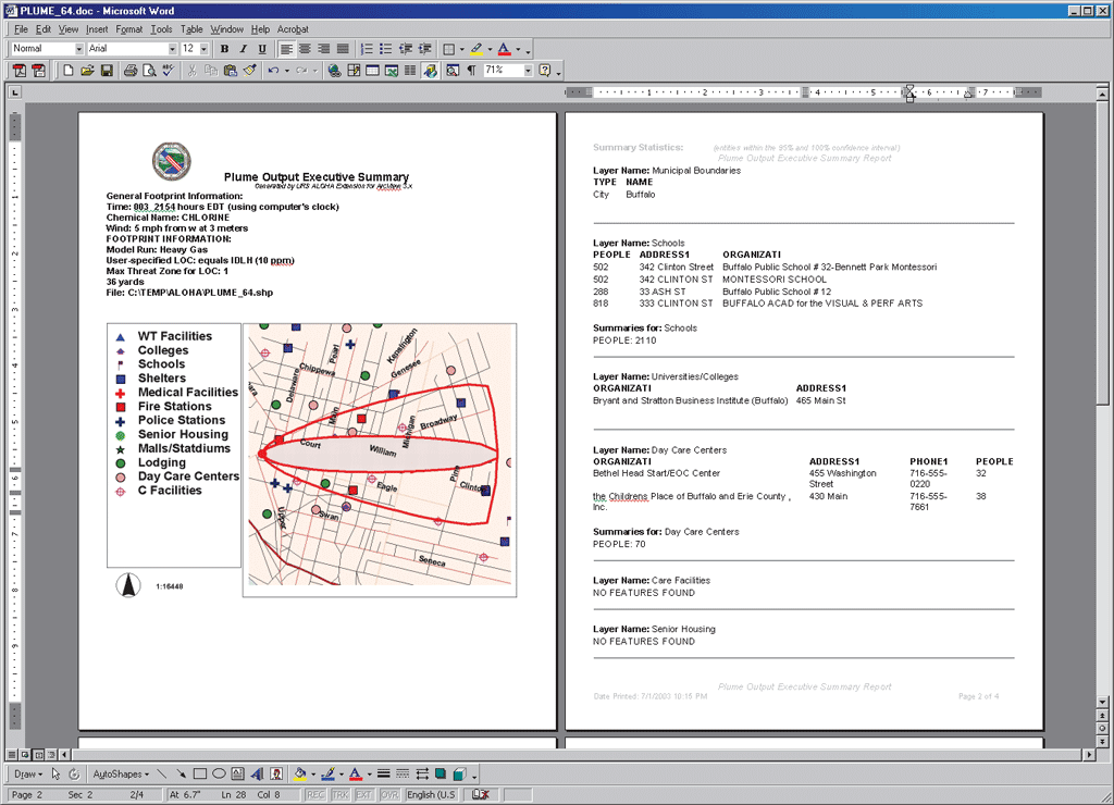

click to see enlargement
The user can create a summary report that is saved as a Microsoft Word file and can include information about the footprint such as time, location, chemical type, model run, user-specified LOC, maximum threat zone, and a footprint map.
It represents an area where, with 95 percent probability, LOC values will be exceeded. The broken "uncertainty lines" that demarcate the larger zone represent potential changes in wind direction that might affect the direction, size, or shape of the plume.
The application processes each of these shapes into a single shapefile with attribute values for each of the two polygons being automatically generated. Once the shapefile is created, it is projected into the coordinate system defined by the user. The projected shapefile is then added to the current view in ArcView. A unique classification scheme based on either of the two confidence category values is applied from a legend (.avl) file. Processing takes 20 to 30 seconds.
Reporting the Results
If the user wishes to create summary reports, a spatial overlay query is run in which the plume created by the application is overlaid against all the shapefile sources defined in the OSR configuration. Attribute values of entities that are found within the plume are then reported to the user. The resultant report file is saved as a Microsoft Word file. The report also includes information about the footprint such as time, location, chemical type, model run, user-specified LOC, maximum threat zone, and a footprint map.
