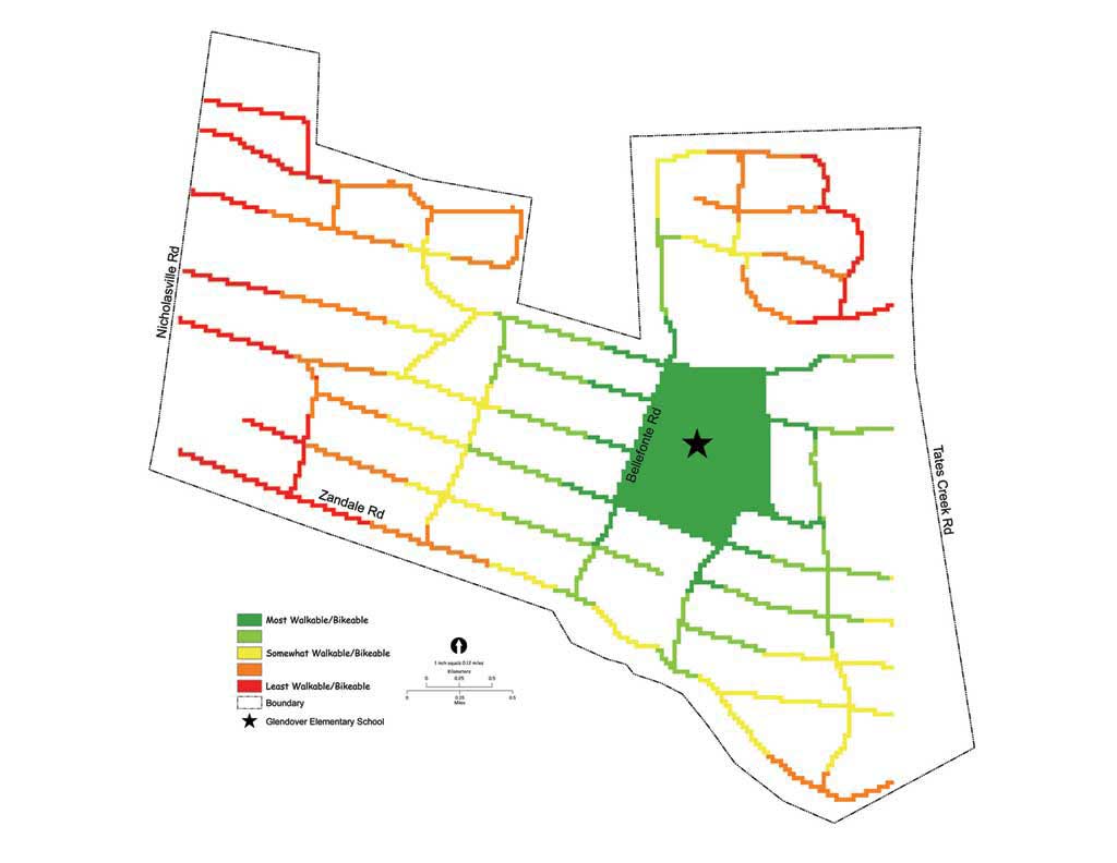

A map depicting the existing walking and biking conditions within the project are

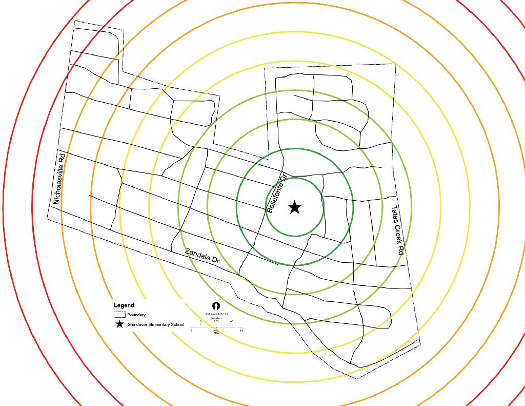

A map depicting straight-line walking distance using 1/10-mile rings

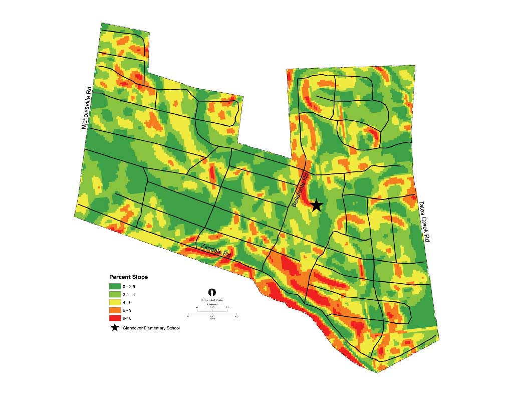

A map depicting the topographic slope found within the project boundary

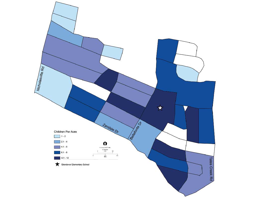

A map depicting the child density distribution in the project area

Walkability and Bikeability Audit
Initially, team members held a brainstorming session to consider what makes a neighborhood walkable and bikeable. As young designers, students are encouraged to draw upon their own experiences when approaching design issues. After developing an initial list of ideas, the team assigned readings and performed an independent literature review to investigate how other people and organizations have approached similar studies.
The team developed a neighborhood audit for streets and intersections that used the Likert Scale rating system. A Likert Scale is a qualitative rating system that is often used to measure judgments. Ratings are indicated along a continuum, in this case on a scale of 1 through 5, indicating the quality of the street or intersection in terms of safety or ease of movement.
click to enlarge
An example of how to set up the Multiple Ring Buffer tool in Analysis Tools of ArcToolbox
Each street segment and intersection was assigned a unique identification number and was rated for walkability and bikeability after on-site visual inspection. Basemaps were prepared from geospatial data available at no cost from the Kentucky Geography Network to aid in field data collection and subsequent analyses.
After the study area was audited, a sample set of streets and intersections was audited again to test the reliability of the audit tool and the team's rating assignment consistency. One team member entered the ordinally scaled qualitative audit data as attributes for a shapefile. The shapefile was used for initial audit visualization and analysis.
