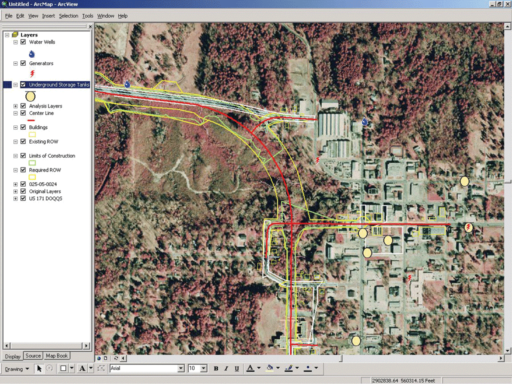

Another major challenge was the format the CAD data would arrive in. Our GIS technicians were familiar with commonly used CAD-based software packages such as AutoCAD and MicroStation, which helped tremendously. We would standardize and clean up the data in its native software as much as possible, georeference it in ArcGIS, then convert it to shapefiles. Advice here would be for state transportation departments to set standards for plan and design submittals. We provided recommendations to LaDOTD engineers for CAD data criteria to incorporate in future scopes of work for contractors. An example of this is to keep required rights-of-way on a separate layer from construction limits. This eases interoperability between GIS and CAD data. These recommendations were part of a larger lessons-learned meeting between LTM and LaDOTD to share thoughts and ideas. We in the GIS Department assumed we were asking a simple question, "Where does one project end and one begin?" When the data from segment to segment began coming into the GIS, we made a basic assessment. There is overlap at the ends of these projects and sometimes significantly. We had to develop a system that incorporated the construction limits and the construction schedule. If a segment was scheduled for construction sooner than another, it took precedence. This was important for the environmental reports; they were written and submitted by project segment. Having a beginning and an end helped, to say the least. When the plans existed in book format for each segment, it was difficult to assess this overlap. EV: How do you work with the other members of LTM and the LaDOTD? JD: GIS provided a common operating platform for data collection, analysis, evaluation, reporting, and communication. LTM staff members across the state were trained to use the Web application. LaDOTD GIS staff was consulted before implementation to ease the transfer to them at the end of the project. There were some datasets that we could not distribute on the Web due to homeland security issues. In that case, we utilized ArcExplorer for an individual, desktop application. Hands-on training was provided as necessary. EV: So you were able to use GIS tools to facilitate environmental documentation and permit applications? JD: Yes. GIS was the primary tool for this process. We analyzed field data for impacts and prepared figures for the permit applications. The figures were also exported into image formats for the electronic versions of the reports. EV: How did that help improve communication statewide? How were you sharing that data before? JD: This leveled the playing field for communication. Departments such as real estate, design, environmental, and other regulatory agencies all had the latest and greatest information at their fingertips. Prior to this implementation, data was not being shared. EV: What is the status of the TIMED Program now? JD: Of the 125 project segments on the TIMED Program, 22 are in the preconstruction phase, 37 are in the construction phase, and 66 are complete as of last quarter. Hurricanes Katrina and Rita and increased global demand for critical transportation infrastructure resources have had an impact on the TIMED program. The challenges faced in completing the program on time and on budget have increased in complexity, and the magnitude of the impacts is becoming more clear as additional project segments are set. Despite these impacts, the TIMED Program is moving forward and assisting in the recovery of Louisiana's infrastructure. It is still on an accelerated schedule for completion and is investing Louisiana dollars back into the economy. The program also maintains an 80 percent residency requirement on all contracts, ensuring it provides in-state jobs for workers. Ultimately, TIMED is building critical evacuation routes, investing in transportation, and providing economic growth throughout the state. Jerri Daniels
