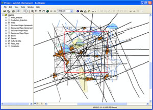

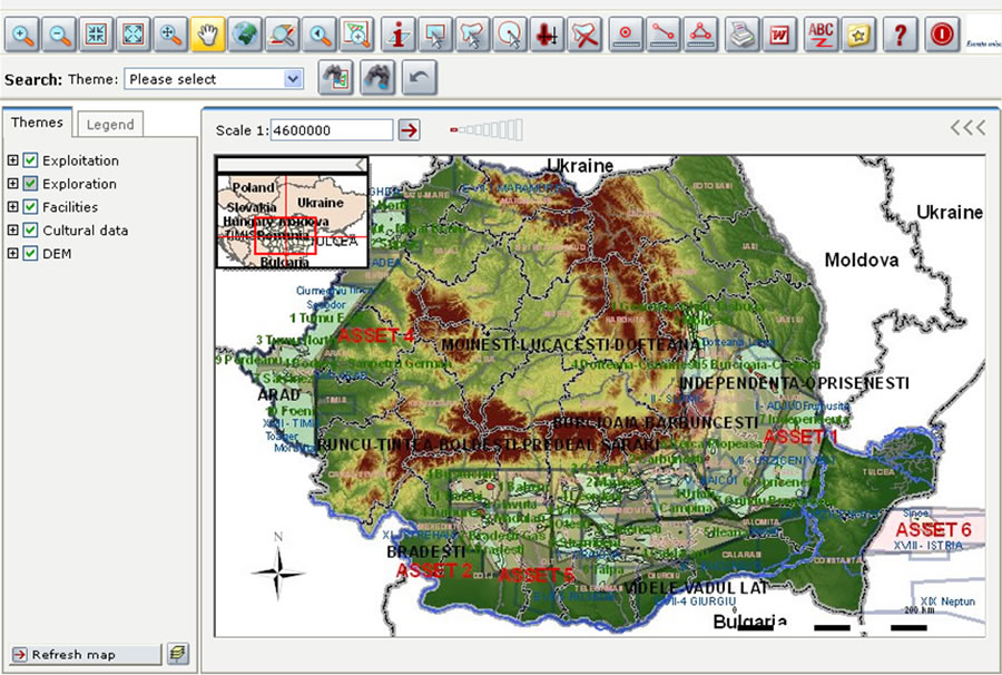

The Web map viewer allows staff to see well data on a map. Here, layers for blocks, seismic, regional, and topographic data are turned on.

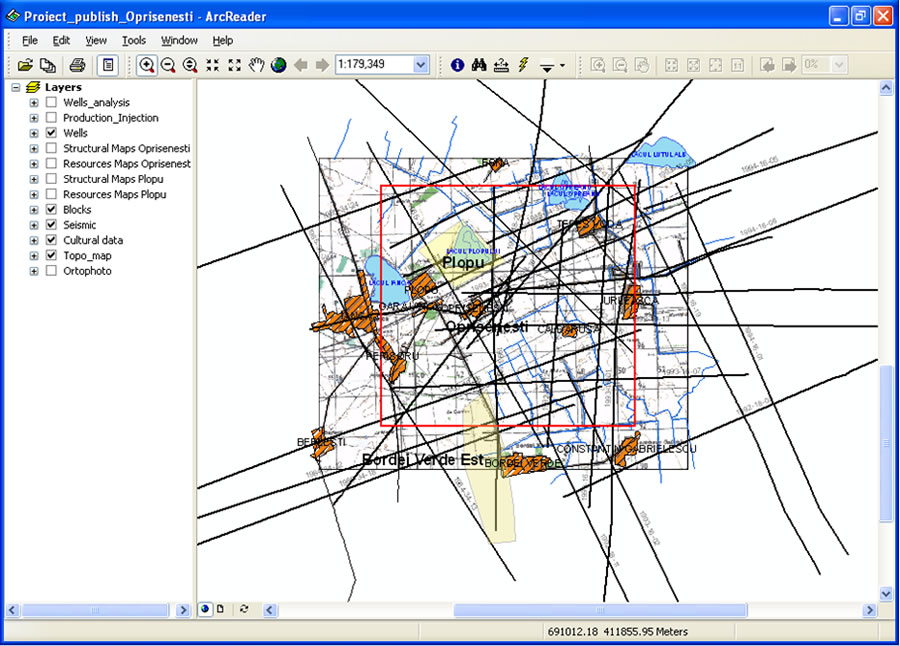

A key feature of the system is WebOffice, which is a Java Web application developed by SynerGIS Informationssysteme GmbH, Esri's distributor in Austria. It runs on ArcGIS Server along with any other operating system that supports the same Java specification. This provides seamless integration of the GIS server with the company's core IT systems. Moreover, the system makes it possible for users to readily access important files and onshore/offshore data for local projects. It offers a Web data viewer via Esri's ArcReader, a read-only viewer that allows the user to interact with the corporate database and use basic mapping tools such as Zoom and Pan.

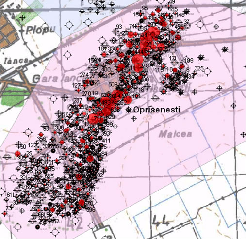

E&P database visualization shows well location and relevant symbology.

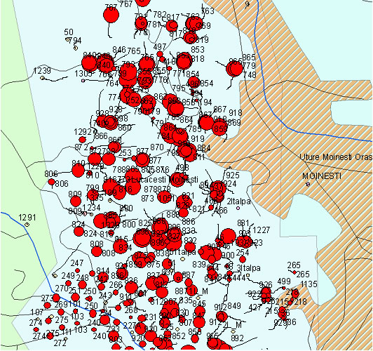

GIS lets users easily understand well data. This map shows cumulative production per well.
