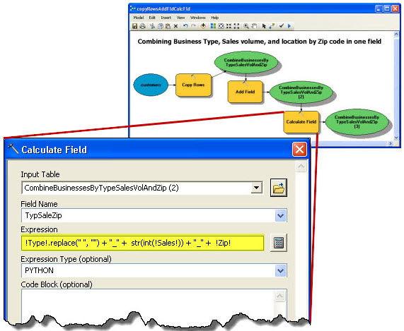

Step 4: Drag the Calculate Field tool, located in the Data Management toolbox in the Fields toolset, into ModelBuilder and connect it to Add Field's output. Open the Calculate Field dialog box and enter the following Python expression:
!TYPE!.replace(" ", "") + "_" + str(int(!SALES!)) + "_" + !ZIP!
To access a field's value and format it, here with the replace (
!<fieldname>!.

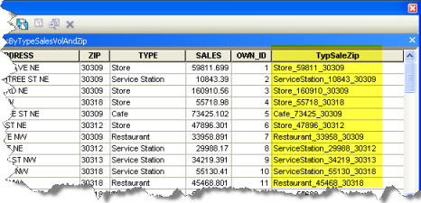

The first part of the expression—!TYPE!.replace(" ", "") up to the plus sign—takes the string of the source field and removes any spaces. The second part of the expression—str(int(!SALES!))—first turns the decimal dollar amount for SALES into an integer using int(), then it turns the integer dollar value into a string using str() and appends it to the business type with an underscore. The third and final piece of the expression—!ZIP!—appends the ZIP Code with an underscore. Here's a section of the result.
Section of the Field Value Formatting Model's Result
