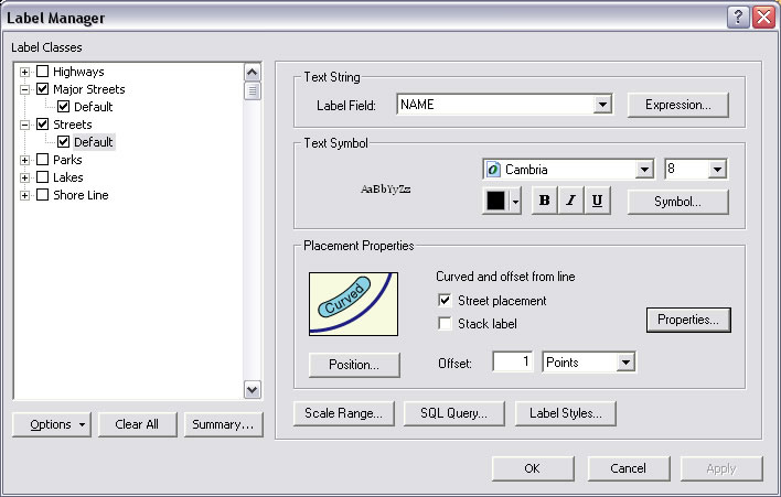

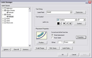

Once Maplex for ArcGIS is activated, its tools are accessed through Label Manager.

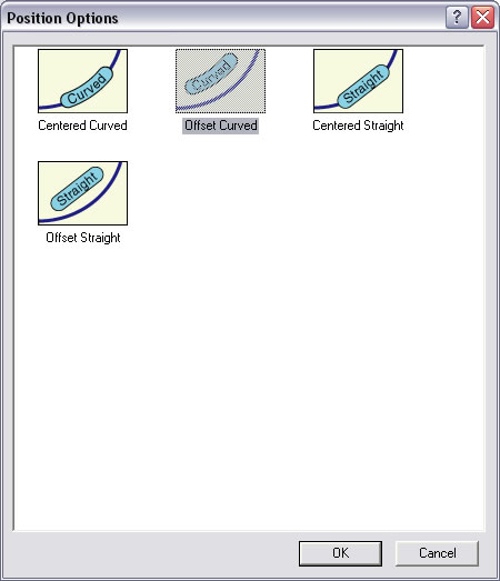

From the Position Options dialog box, choose how to place the labels in relation to features.

Maplex for ArcGIS supplies additional tools in Label Manager for tuning label placement for all types of features. Click the button next to the Label drop-down on the Labeling toolbar to open Label Manager. In Label Manager, check the box next to the Street placement box in the General section. To tune where the label will draw in relation to the street feature, click the Position button. In the Position Options dialog box, choose the desired label location.

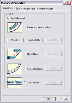

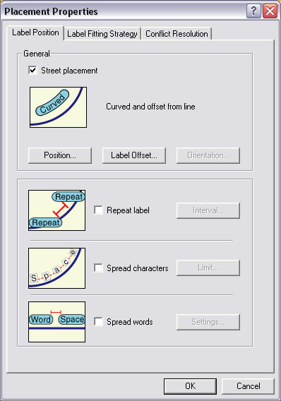

To access other placement settings, such as offsets or spacing, click the Properties button in the Placement Properties section of the Label Manager dialog box. Click the Label Position tab of the Placement Properties dialog box. This tab provides choices for controlling how often a label will appear on a street, spacing between characters, and words in a label. The other two tabs on the Placement Properties dialog box contain additional controls for fitting labels and resolving label conflicts.

The Placement Properties dialog box offers three tabs full of additional controls for resolving conflicts and changing the appearance of labels.

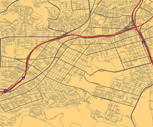

Just a few quick selections from the Position Options and Placement Properties dialog boxes refine the position and display of labels in relation to map features for greater clarity.
