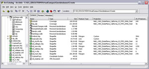

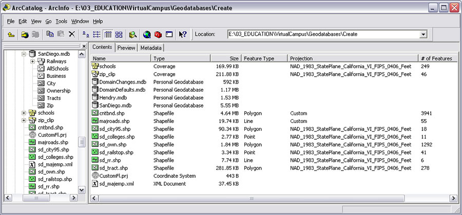

Customize ArcCatalog to display the infor-mation you find useful for locating datasets.
You can easily change ArcCatalog to show information about your data in the way that is most convenient for you.

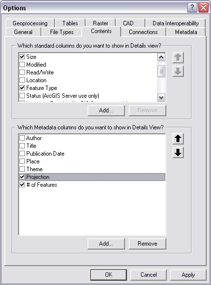

ArcCatalog offers several views—large icon, list, detail, and thumbnail—but the detail view is often the most useful. By default, this view supplies the file name and type but can be modified to add standard columns, such as feature type or last date modified, and metadata columns, such as publication data, projection, and number of features, with little effort. Column widths can be adjusted simply by dragging the dividers between them.
Enable additional columns by choosing Tools > Options and clicking the Contents tab. In the Options dialog box, check the desired columns and click the Apply button at the lower right side of the dialog box (not the Add Button immediately below the checklist). Once these columns are enabled, contents can be sorted based on any of these fields to locate data by a characteristic such as feature type or publication date.
  click to enlarge
Turn columns on or off by choosing Tools > Options and clicking the Contents tab.
