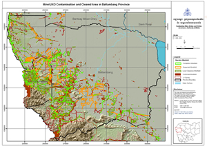

This map shows suspected land mine fields in orange and confirmed land mine fields in red in Battambang Province in Cambodia. The areas marked in green have been cleared of mines. Image courtesy of the CMAA.

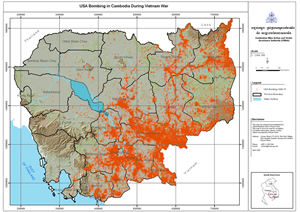

This map shows in orange the locations of where the American military dropped bombs in Cambodia during the Vietnam War. The data was supplied by the U.S. government. Image courtesy of CMAA.
