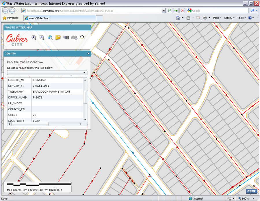

A project goal was to hyperlink sewer plans to the GIS-based sewer line data so that the information would be accessible via the Online Sewer Access System Web application. The database was created using ArcGIS Desktop from Esri. To improve the Web application's functionality, the city recently launched Esri's ArcGIS Server. The site provides information to engineers and contractors who must determine where to connect private sewer pipes to the public sewer main. Public works field crews use the site to research and obtain plans. When a user visits the city Web site, the Web application displays the sewer map. With a click on a sewer line, the user can retrieve a scanned PDF of the as-built plan.

The new Sewer Web Application offers more map space, has a cleaner look, and is more user friendly then the previous Web Application.
"We used numbers in each field of the attribute table within the GIS data to designate the status of sewer plans," Mendez said. "For example, I would place a 0 in the attribute information if the sewer line was not in need of attention. A 1 means it is missing a sewer plan. A 2 means the plans could not be scanned and needed to be contracted out. A 3 indicated there was a question for the sewer maintenance manager."

The Online Sewer Access System map shows sewer pipes, flow direction, manholes, aerial imagery, parcels, pump stations, pumps, and wet wells. Sewer data is served on top of city infrastructure layers such as streets and city boundaries, all within the GIS. Users can navigate based on address or intersection, click on a line or point, see the attribute information, and view associated scanned drawings that have been hyperlinked.
The city's sewer data now includes construction material, footage, year installed, tributary, and ownership data. Material, size, and diameter of all pipes have been documented as well as digitized outfalls—large-diameter sewer pipes that take Culver City sewer flows to the sewer treatment plant. There is also manhole data including small access points, called cleanouts, that reside on private property and larger sewer maintenance access points, called lamp holes, that are located in alleys. Such geographic points were not included in previous versions of sewer maps. Mendez is currently adding manhole identification numbers that correlate with mapbook pages to further assist field crews.
