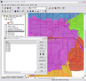

One click from the top menu in ArcMap, ArcScene, ArcGlobe, or ArcReader gives you access to Bookmark Manager.

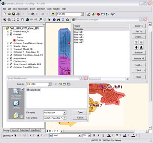

Save bookmarks to an ArcGIS Place (.dat) file to use bookmarks in other map documents or share them with coworkers.
In ArcGIS 9.3, you can access bookmarks directly from the top-level menu in ArcMap, ArcScene, ArcGlobe, and ArcReader with a single click.
Bookmarks let you zoom or pan to a predefined extent and location on a map in one step, eliminating time spent recentering and redrawing the map. All bookmarks are stored in the map document, but each data frame has its own bookmarks. If the map is in layout view, only bookmarks for the active frame are displayed.
Bookmark Manager has been redesigned with this release. Bookmarks can be reordered and removed with ease. All or selected bookmarks can be saved to an ArcGIS Place (.dat) file. Hold down the Shift or Ctrl keys to select multiple bookmarks to save to a .dat file. Bookmarks saved to a .dat file can be loaded in other map documents you have or shared with other users.
