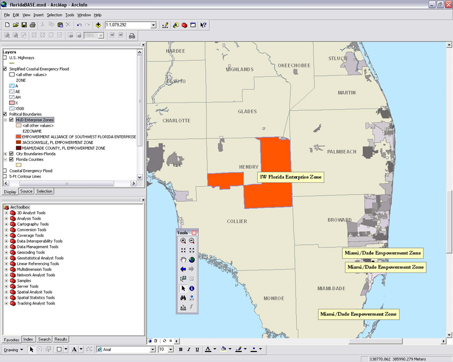

Setting scale dependent display for layers avoids this ugly scenario: labels and features displayed at an inappropriate scale.

The Zoom To Make Visible tool is available from the context menu when scale visibility is set and the layer is not visible because it is out of scale.
click to enlarge
Using the tool, ArcMap zooms to the nearest scale that will display the desired layer.
Using the Zoom To Make Visible tool is much quicker than determining the visibility level of the layer properties and zooming to that level.
