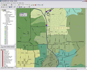

Click on a Location to Get the Address
  click to enlarge
In addition to identifying an address interactively, you can also copy or add a graphic, label, or callout to the location.
Address Inspector, a new tool available in ArcGIS Desktop 9.3, can retrieve an address; copy it to the Windows clipboard; and add a graphic point, a graphic point and label, or a callout to the address location.
Address Inspector is available from the new Geocoding toolbar. This toolbar also contains Address Locator Manager as well as the Geocoding Addresses and Review/Rematch Addresses tools. Before you can use reverse geocoding, you must perform these three steps.

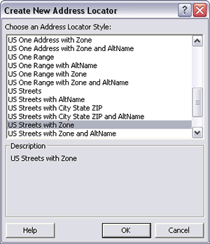

  1. Open ArcCatalog and right-click on the file or personal or ArcSDE geodatabase containing the street feature class that will be used. Choose New > Address Locator from the context menu.
  2. In the Address Locator dialog box, select an appropriate address locator style and click OK.
  3. Give the address locator a name and save it in the geodatabase containing the street data to be used for geocoding.
  click to enlarge
In ArcCatalog, create an address locator for the street data that will be queried for address by location.
In the Create a New Address Locator dialog box, select an appropriate address locator style.

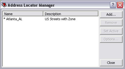

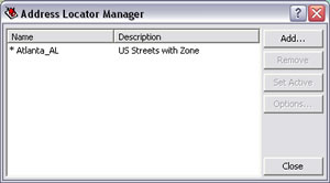

  3. Click the Address Locator Manager in the Geocoding toolbar. In the Address Locator Manager dialog box, click Add and browse to the location of the address locator created in the previous step.
