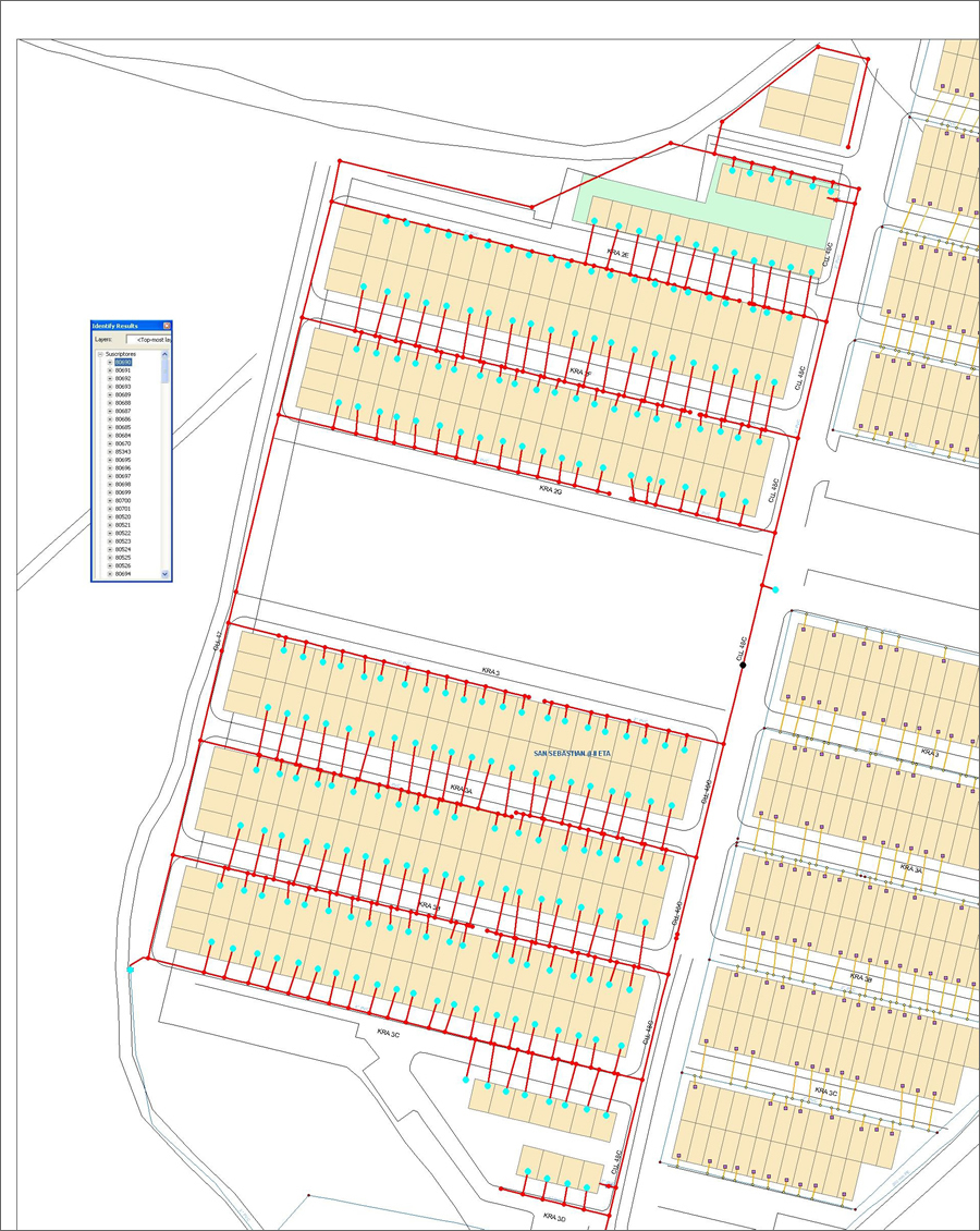

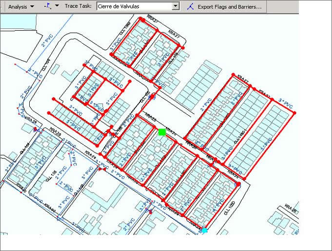

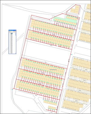

The network trace feature produces a view of water service that would be affected by valve closures during repair work.

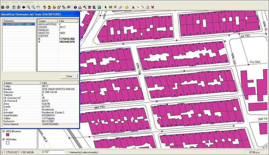

A detailed map of the Aguas de Manizales water utility infrastructure gives multiple departments access to up-to-date information, including meter connections.
Now, when a system break occurs, network personnel still make an on-site inspection, but they report back to a GIS analyst at the company's call center. Because all valves now have a unique GIS identifier, the analyst can use a valve isolation trace tool to specify how many and identify which valves to close in order to minimize interruption of service to customers. The analyst also uses GIS to look up part specifications for needed repair materials.
By using GIS, the utility has reduced outage response time from 12 hours (for a three-inch pipe break at 1.8 breaks per network kilometer) to 4.5 hours (at 0.7 breaks per kilometer). Improvement in service has also been reflected in customer satisfaction surveys.
