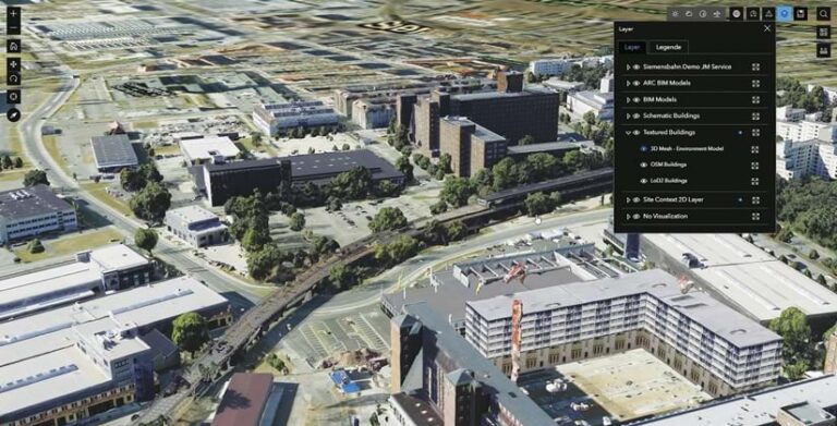

A 3D, aerial-view map of the Seimensbahn light-rail link, showing buildings, trees, and roads. A Layer menu shows options for displaying different types of buildings and environment models.
Using ArcGIS technology enabled the team to combine detailed models of the railway viaducts with satellite images and less-detailed, textured buildings.

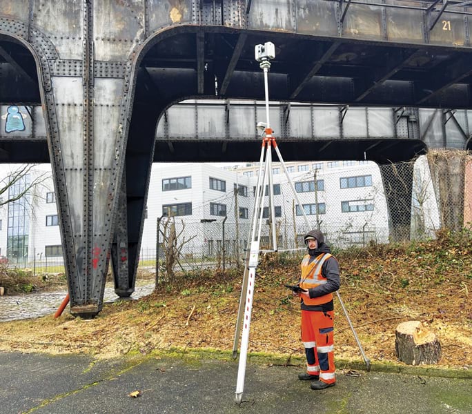

A surveyor in an orange work suit stands near a surveying instrument mounted on a tripod, beneath a large, riveted steel viaduct. A modern building is in the background.
The team from ARC-GREENLAB took 3D laser scans of the existing viaduct.

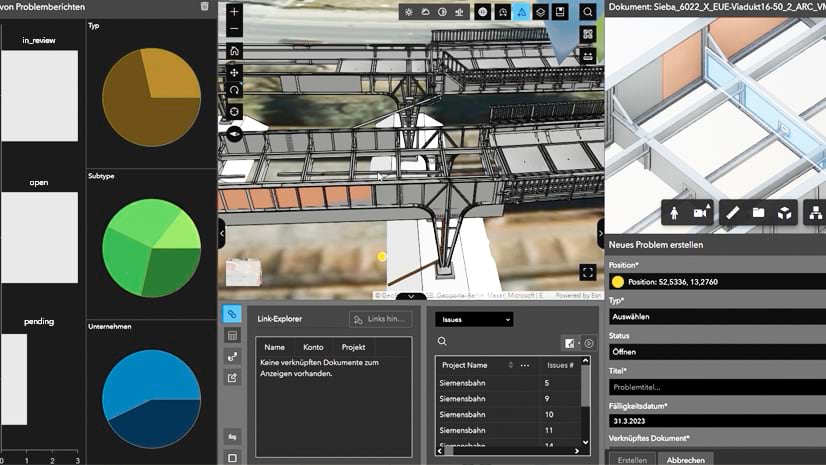

The team noted any planning issues in the models, such as existing structure deformations, and presented these in a dashboard made with ArcGIS Dashboards, as well as in an ArcGIS GeoBIM app to increase user accessibility among surveyors, planners, contractors, and engineers. Once construction begins, additional stakeholders can be invited to use the applications. The planning and construction models are developed simultaneously because any changes made to the planning model, in turn, affect the model developed for construction. Any issues that are found can be resolved in Autodesk Forma.
The planning and construction models are highly detailed at LOD 400. They include comprehensive representations of components that can be used for assembly planning and development. The precise model information available in LOD 400 allows the team to calculate the costs of the work as well.
“The planning and construction models are also used to verify any new structural calculations,” said Götzel. “Identified issues in the calculations are assigned to their respective BIM model in the [Autodesk Forma] environment, and the person that identified the issue is notified when the necessary changes are made to the design. As a comprehensive project platform, ArcGIS GeoBIM provides access to relevant data for other stakeholders involved in the project.”
