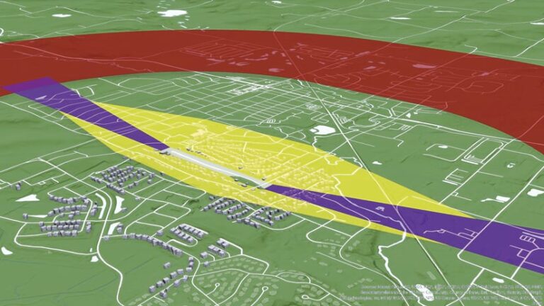

An aerial map of a small city with an airport runway in the center, overlaid with two yellow zones on each side of the airport, two purple zones extending diagonally up from each end of the runway, and a red circular zone going around the airport at a distance.
A 3D scene, designed in ArcGIS Pro, helps airport stakeholders visualize buildings that penetrate the airport’s Part 77 transitional surfaces, shown in yellow. The Part 77 approach surfaces, shown in purple, display an unobstructed path to and from the runway.
“This gives us the ability to evaluate and quickly analyze current and potential obstructions, such as trees, towers, or buildings, while allowing users to look at the data three dimensionally and compare it to other 3D data,” Koeller said.

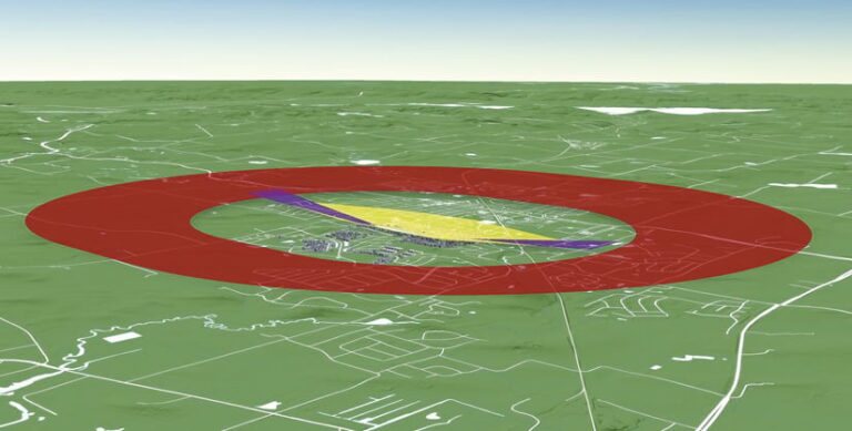

A zoomed-out aerial map of a small city with an airport runway in the center, overlaid with two yellow zones on each side of the airport, two purple zones extending diagonally up from each end of the runway, and a red circular zone going around the airport at a distance.
The red circle represents the Federal Aviation Regulations Part 77 conical surface. Due to its height above the ground, the conical surface is most often used to evaluate impacts from wind turbines and other tall towers.
