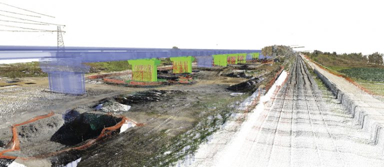

A model of a viaduct superimposed onto imagery of the area, with the pillars that have already been constructed highlighted in green and future construction highlighted in purple
FSTechnology compares 3D point cloud surveys taken by drones with its building information models to monitor construction progress. The pillars in green have already been built, while everything else is from the model.

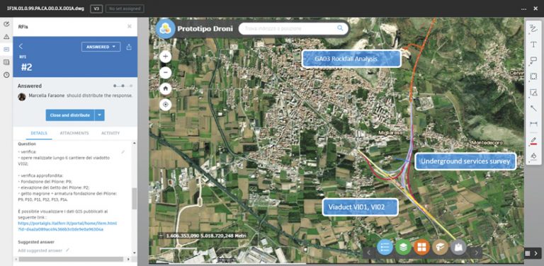

A map of a city or town with markings on it that indicate where a drone will fly to capture imagery
The team uses Autodesk and ArcGIS technology to plan drone flights.

“The 3D point cloud surveys collected with the drones are compared with our BIM models so that we can monitor construction progress,” said Faraone. “We use Autodesk’s Navisworks to compare the point cloud with the BIM model. With its clash detection functionality, we can compare the difference between the planned construction and the actual work in progress.”
To process the point cloud so it can be compared with the BIM model, the team reduces the size of the point clouds to contain only the necessary points and data and then combines different point clouds to obtain the entire model of the project. Sometimes the team has to transform point clouds into surface models or 3D objects, and staff often create digital elevation model (DEM), digital surface model (DSM), or raster RGB (red, green, blue) files as part of this process. Then details, like color, are added. The team can also make digital skins of the construction and add that to the 3D model created from the point cloud to make it look more realistic.
