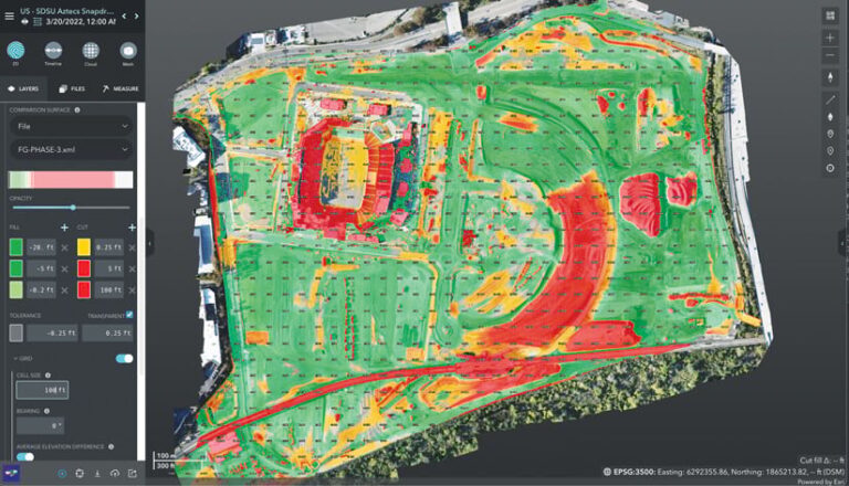

The Site Scan for ArcGIS interface showing an aerial image of the new stadium under construction with flat surfaces shown in green and sharp-grade surfaces shown in red
Processing and analyzing imagery with Site Scan for ArcGIS allowed project stakeholders to compare the original grade of the construction site to the final design of the stadium.

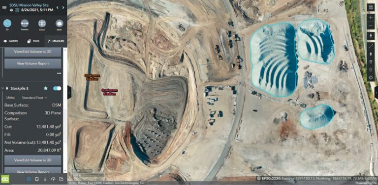

Within the Site Scan interface, an aerial view of the early stages construction site that shows three large holes in the ground highlighted in blue
OCMI, Inc., used Site Scan to run volume calculations to find out how much material was excavated from the old stadium.

On the Snapdragon Stadium construction project, using Site Scan enabled OCMI team members to obtain the metrics they needed for their client. When the original stadium was being taken down, construction personnel created large stockpiles of concrete, and an on-site batching plant was set up to reprocess it. OCMI was asked to get quantity takeoffs on the stockpiles—that is, to estimate materials—and Dorsey and his team were able to use Site Scan to run volume calculations that told grading subcontractors exactly how much material was excavated.
An aerial orthomosaic of the stadium and the surrounding grounds, streets, and parking lots
A true orthomosaic, produced using drone imagery and processed with Site Scan, shows the completed stadium.
“When we were faced with a change order request, we were able to quantify exactly how much material was in the various three stockpiles on-site, which then we were able to [use to] thwart the claim that there wasn’t enough material to fulfill the base [of the stadium],” Dorsey said. “So that was a big win for having [Site Scan].”
