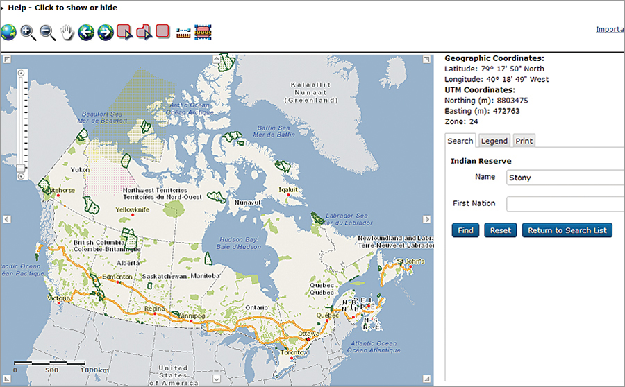

All elements of the Canada Lands Survey System (CLSS) Map Browser are accessible to blind or partially sighted people, including all buttons, tabbed menus, entry and drop-down boxes, and Esri's map itself.

To enable blind and partially sighted people to navigate, the branch used drop-down menus that permit users to choose one value from a list of jurisdictions at the first level and another drop-down menu to choose one value from a list of units at the second level. With the screen-reader software, these graphical user interface elements can be readily used by blind and partially sighted people.
In addition, users can use their keyboard arrow keys to navigate the map in cardinal and ordinal directions (north, east, west, and south, as well as the directions in between). They can also use the plus (+) and minus (-) keys to zoom in and out if further zooming or panning is required. This functionality is fully integrated in ArcGIS API for JavaScript and does not require any additional programming on the development side. Those are invaluable features of the API that cannot be overemphasized, since developers can appreciate how laborious it is to implement new map navigation functions in general and accessible ones in particular.
Thus, regardless of input method—pointing device, keyboard operation, or drop-down menus—users are able to navigate to a particular unit of interest.

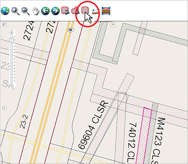

Providing users with the option to select features within the current map extent empowers users to spatially select features without a pointing device.
To provide blind and partially sighted people with the ability to select features on a map without an appropriate input method—that is, spatial queries—seemed to be a bigger hurdle. However, the branch implemented a solution that employs a button to trigger the spatial selection of all features covered by the current view extent (the area visible on screen after zooming in). The results are then posted back to the screen, where they can be reviewed by the user with the screen reader. If the resultant selection set of features is too large, then the user can refine the view area with further zoom/pan operations.
